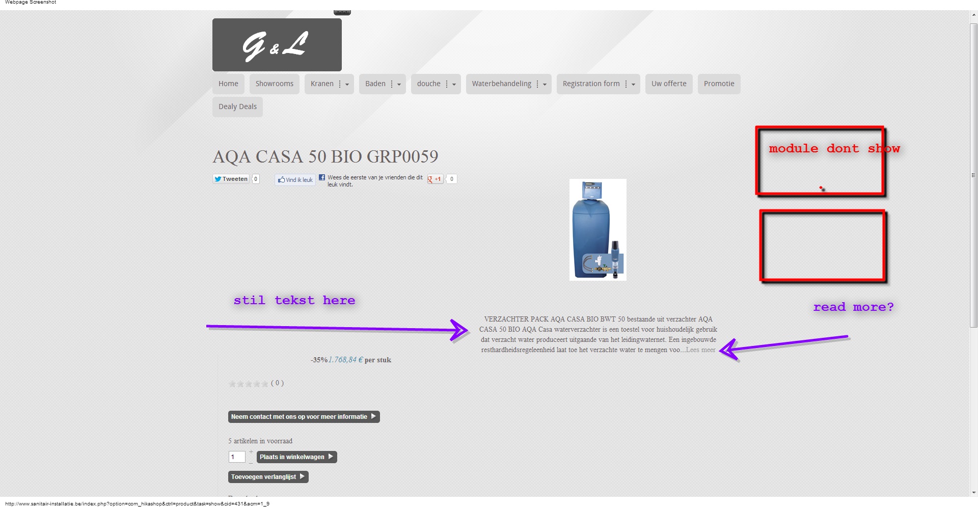

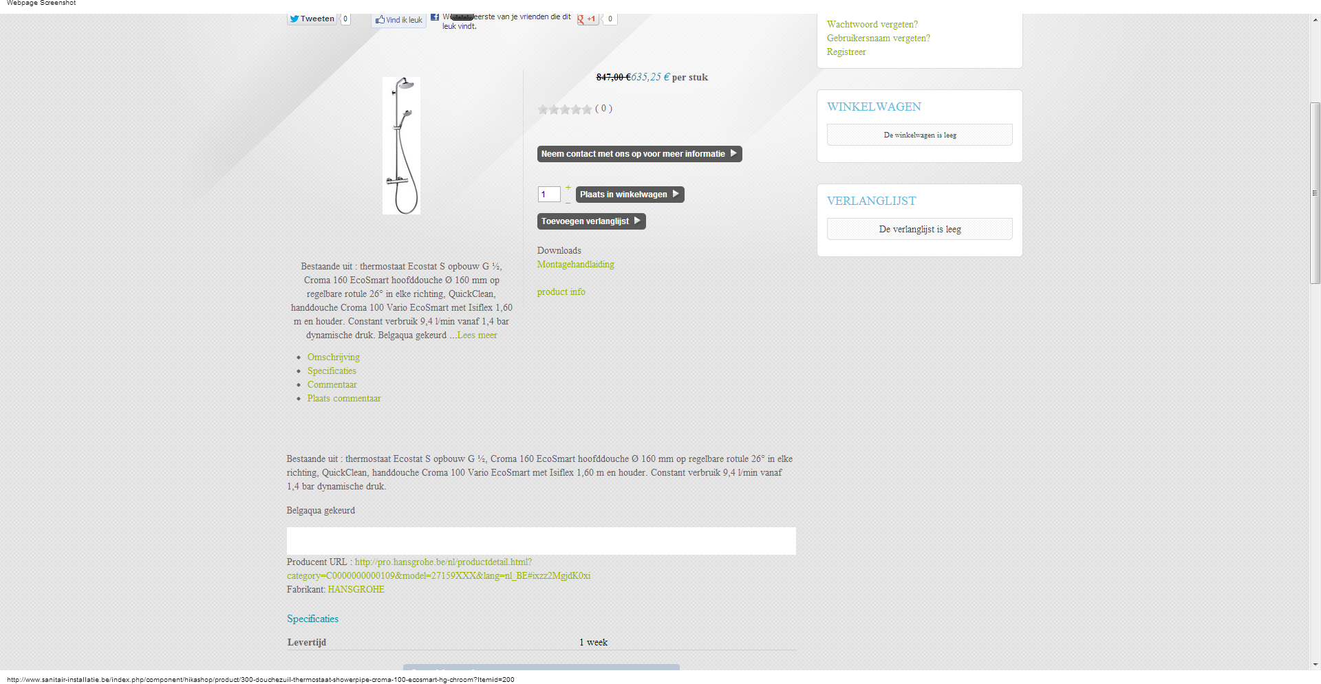

  • Posts: 80
11 years 8 months ago #95554
sorry to get back to this question
I put back my backup but the tekst that I wont to remove is still there
I have change the code but no result
also if I push the read more button or go directly go to a product like from newsletter
then the module are not there and the view of the product page change
I put the read more button of in hikashop but still showing
thanks for any help
regards

  • Posts: 82863
  • Thank you received: 13372
11 years 8 months ago #95707
Simply add the CSS below in your frontend CSS file of HikaShop and that will hide that part:
.hikashop_product_description_main_mini{ display: none;}
The following user(s) said Thank You: luppe
  • Posts: 80
11 years 8 months ago #95732
thanks Nicolas
that working :)
regards
