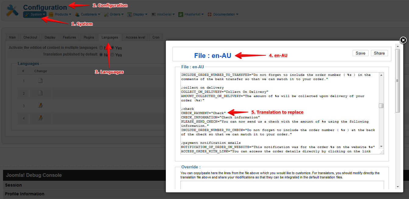

11 years 10 months ago #97356
In Configuration > Languages, you should have a add button. Click on that button to create the australian language file, then edit it and add an overrive fot the check payment method.
to replace CHECK by CHEQUE, and you can do that for the other overrides.

11 years 10 months ago #97884
When using a language in Joomla, HikaShop automatically add it in the HikaShop language files.
Then you have to edit this language file to have your translations.
They will be automatically loaded if the language site in en-AU.
