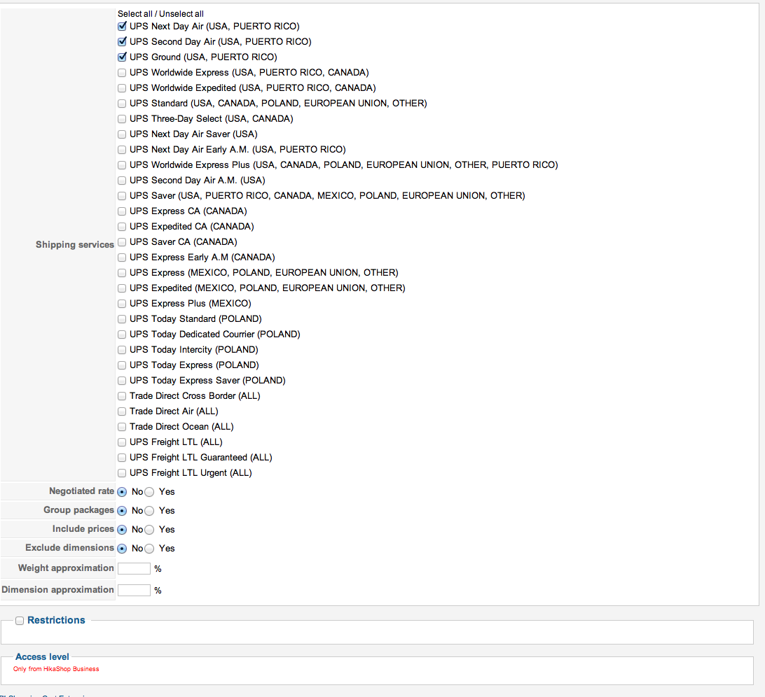

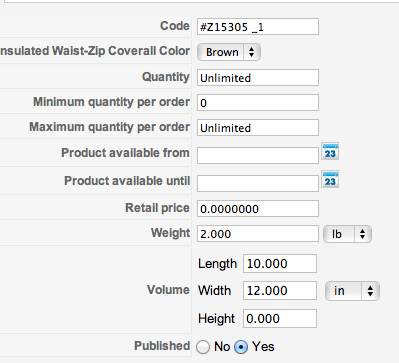

I am having this same problem. I have only the UPS shipping method published. It is the only method I want to use. I have weights and dimensions for the product I am testing with. My site is nchuntingandfishing.net .
The product I am testing is Men's Apparel -> Men's Workwear Coveralls -> Insulated Waist-Zip Coverall -> Brown Color. When this product is added to the cart, I get the "No Shipping Method Found" error. I have read hundreds of posts on this forum, I have gone thru the FAQ's a dozen times and I have yet to figure out the problem. I have attached screenshots of my product details, my UPS shipping plugin settings and will provide any other supporting documents needed to figure out this problem. I really don't know why this as to be so confusing.
I will gladly provide access to my backend if needed. I just need to get this cart working. I have spent way too many hours trying to get this going and all I have read on here does not help. thanks for any help you can provide. I have another site that I want to use this cart on as well, but if it takes this long to get it up and running, I don't think I can afford to use it.
Last edit: 11 years 3 months ago by brob34. Reason: remove image

For the item I was testing, I did have weight and dimensions set. it still doesn't work. Where did the image you attached in your last reply come from? I still ave the same problem. Do I have to have dimensions for all products before I can get this to work?
  • Posts: 29
11 years 3 months ago #117929
You can see from my original reply the screenshot showing dimensions and weight for the product I was testing. Is there something else I need to do? I really want to get this cart working. I plan to move to the commercial version when I get it working and also ave two other sites where I would like to use it if I can get it working. Please help me get this working properly.

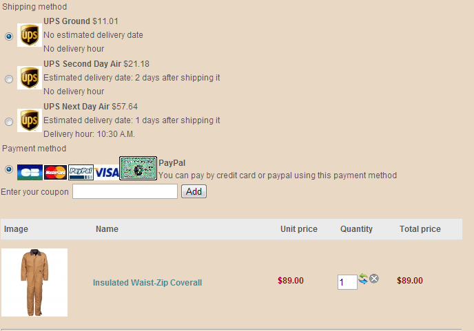

11 years 3 months ago #117936
It wasn't working because you have set the height of your product to 0, I tried it with a height set to 1 and it's working fine :).
  • Posts: 29
11 years 3 months ago #117938
Outstanding! I appreciate your help and will continue to use your product!
