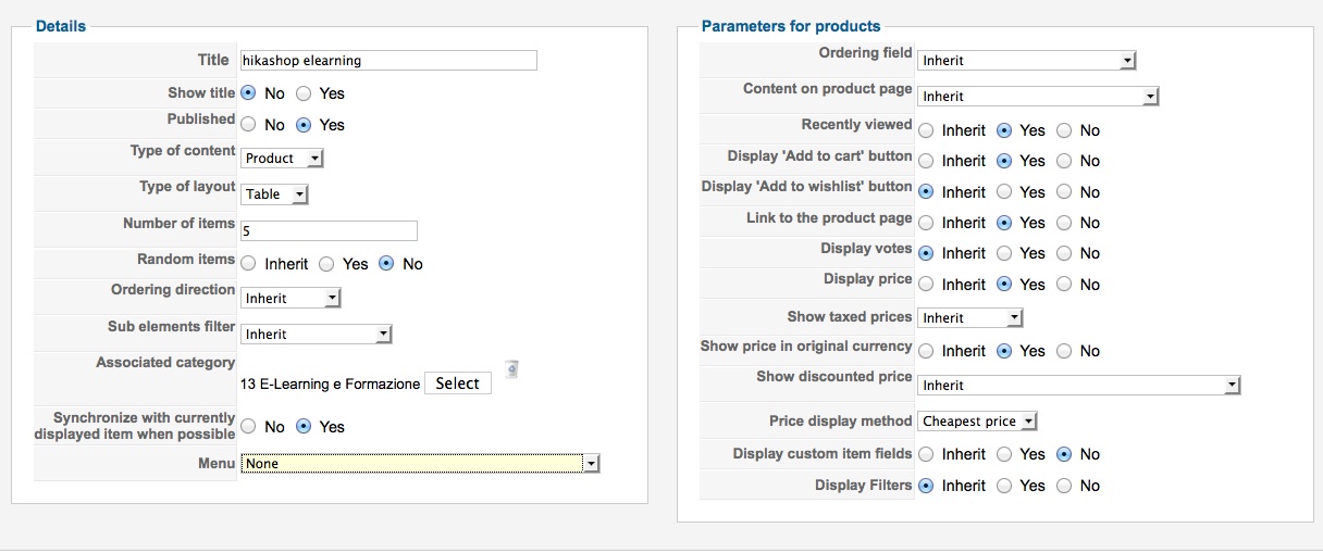

I don't see any pagination on the listing of products.

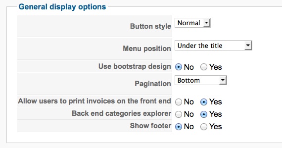

Pagination works well for menu with modules associated,
it will not work for modules placed directly on the page [mod_hikashop]
that works here: www.insegnalo.it/catalogo-corsi-online/c...earning-e-formazione
But not work here: www.insegnalo.it/corsi-elearning-e-formazione

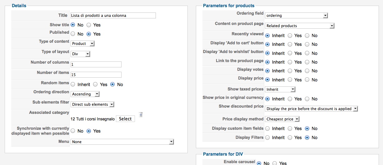

Both pages take data from the same category
The configuration is almost the same and I haven't random options.
Attachs two configurations
Where can be the problem?
Fabio

Joomla modules don't have pagination. The pagination is only available when you're in the main content area (so modules in the main content area also get the pagination).

If you want to display all the products in a page with pagination, then simply create a products listing menu item.
There is one created by default when you install HikaShop which lists all the products with pagination.
I've actually never seen a website with a pagination in a module position. For example, I don't know of any module to display a joomla articles listing with pagination. Actually, the joomla pagination system didn't even support that possibility until Joomla 3.0 as you could only have one pagination per page.
So I would say it's both technical and a design choice since previous versions of joomla didn't allow for that and that I don't see the usefulness of that.
Lastly, if you would something resembling to a pagination in a module, you can use the carousel system :
demo.hikashop.com/index.php?option=com_c...5&Itemid=103&lang=en

As I said, you can use the carousel system for that:

...but the carousel only works with DIV layout?
I want to display the table layout with carousel.
thanks

11 years 10 months ago #97391
Indeed.
You can't use the carousel with the table layout so you can't have pagination for modules with the table layout.
