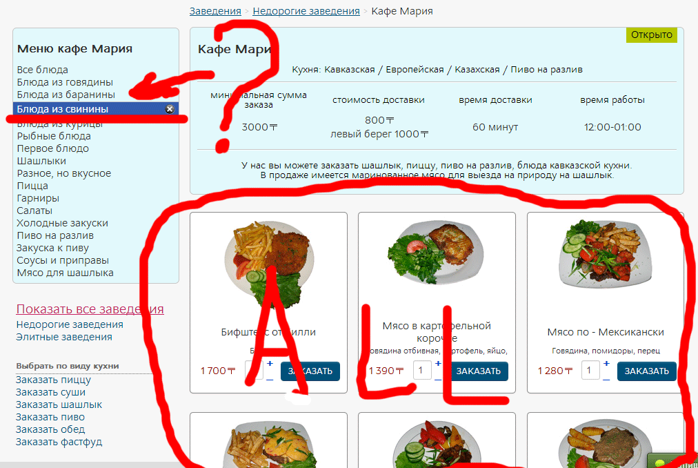

  • Posts: 178
  • Thank you received: 5
11 years 9 months ago #113864
PeterChain wrote: Anyway this is not still the right solution as you may get reseted filter but the Filter controls remain with the X sign to get them cancelled even they are already cancelled.
Yes. Filter module shows that filter is applied, but all products from category are listed. How to reset selection in module too? It confuses the site visitors.

Eliot wrote: Hi there,
The last Hikashop version includes the possibility to display a reset button.
You can find this option in System>Configuration>Features>Filters
I want clear filter after change category without pressing any buttons. Just open category and there is no any filter applied...

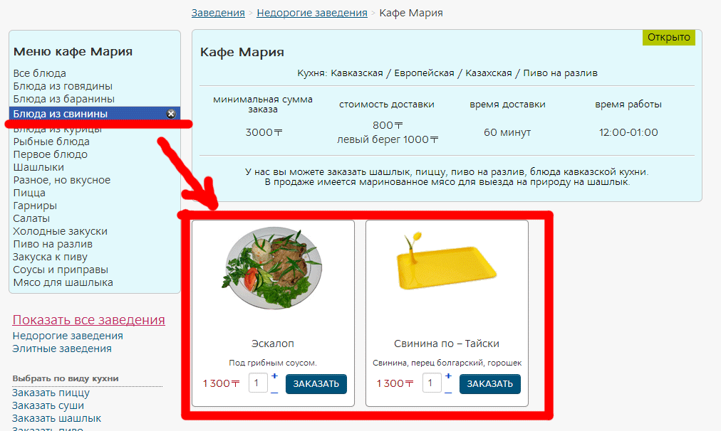

11 years 9 months ago #114061
Actually this is the current behavior of the filters, it's reseted for each category.
Could you please give me a link to your website so I can test it?
It's in russian. I think you don't understend anything on this site.
When I use filter, it works and show for example 2 products from category
But when I change category and then return here again, there will be listed all products, but filter module shows like filter is still applied. But really no filter is applied.
