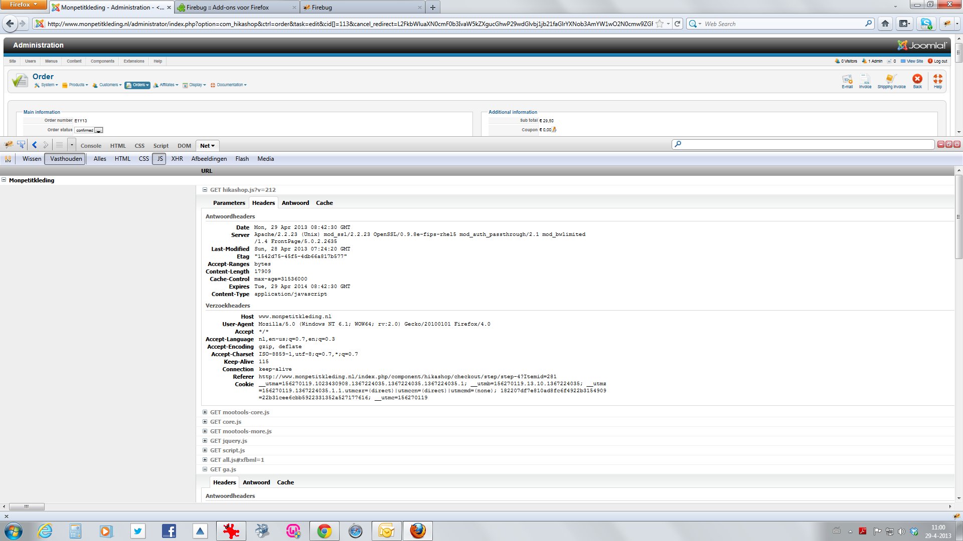

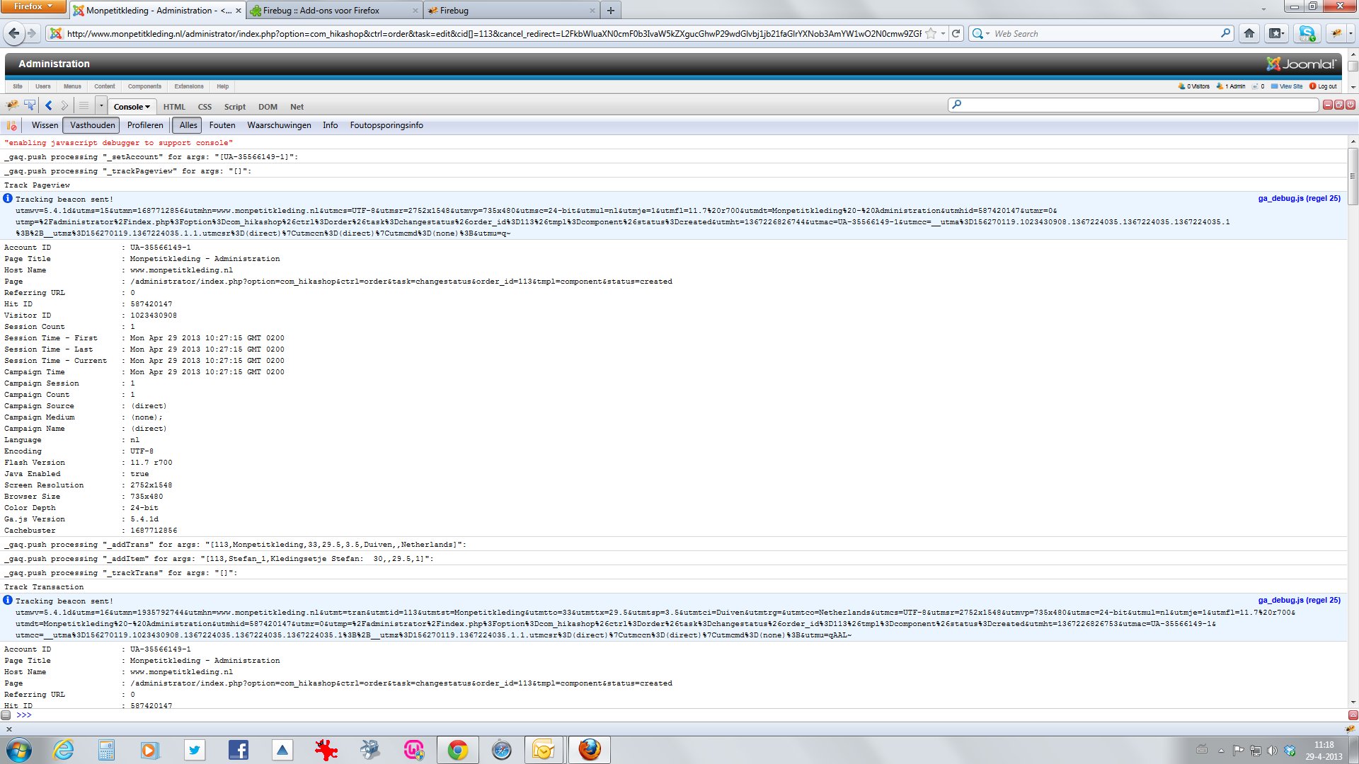

  • Posts: 106
11 years 11 months ago #101407

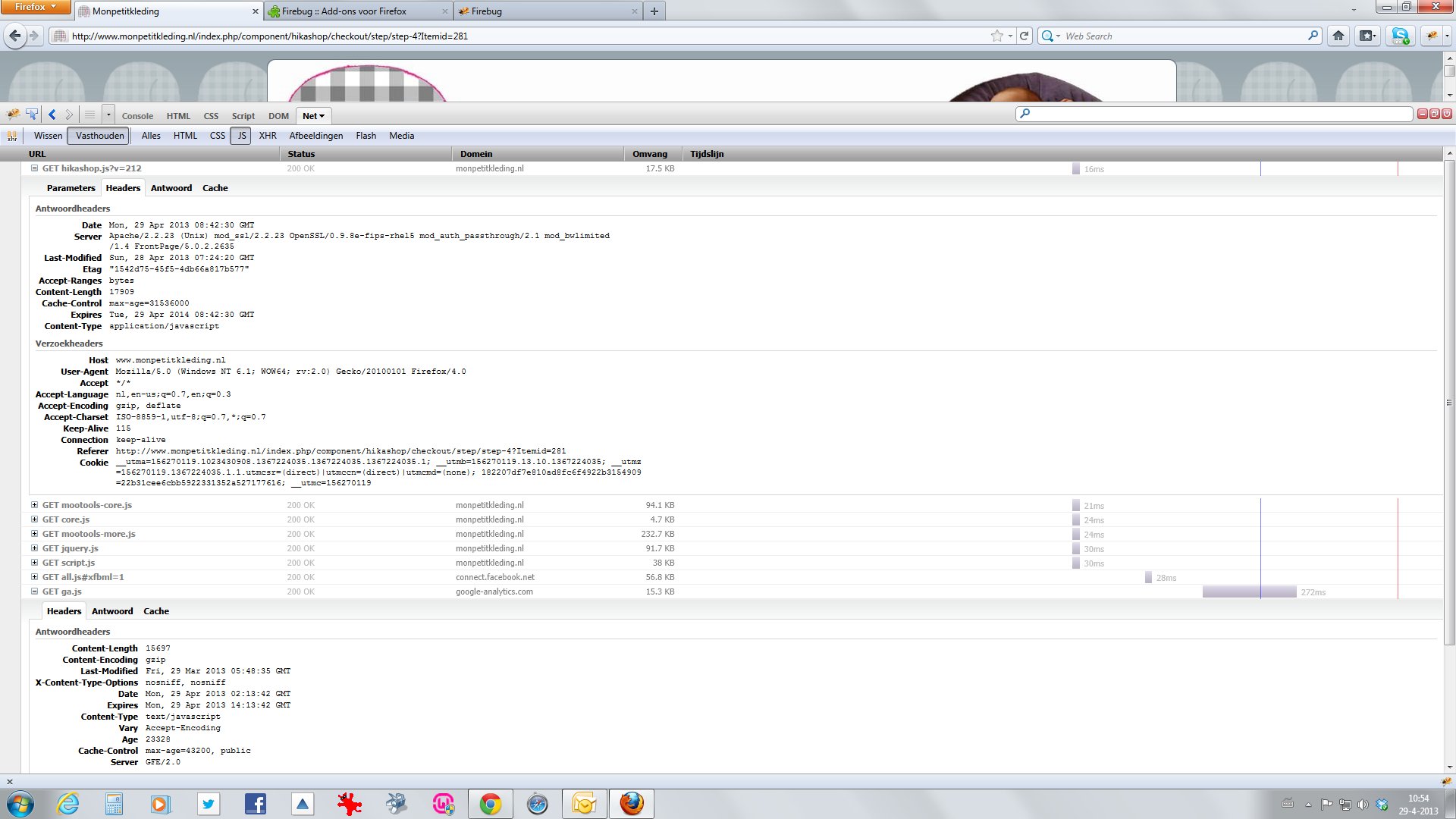

Is this where you looking for?
The debug mode of hikashop plugin is on "yes"
I hope you can help me with this.
Best regards,
Gerard

  • Posts: 83604
  • Thank you received: 13536
11 years 11 months ago #101672
Your last screenshot is indeed what we need:
www.hikashop.com/media/kunena/attachment...ytics_back-end_2.jpg
As you can see on it, the order details (orer id 113 by someone in Duiven, with 1 product Stefan_1 costing 29.5) are properly sent to Google Analytics.
And the debugger doesn't give any error so it is successful.
You should normally see that order in the ecommerce area of your GA account less than 48h after that (it can take several hours).
If you don't see it after 48h, then maybe there is an issue with your GA account. I encourage you to contact GA's support with that screenshot and ask them why you don't see the transaction in your account.

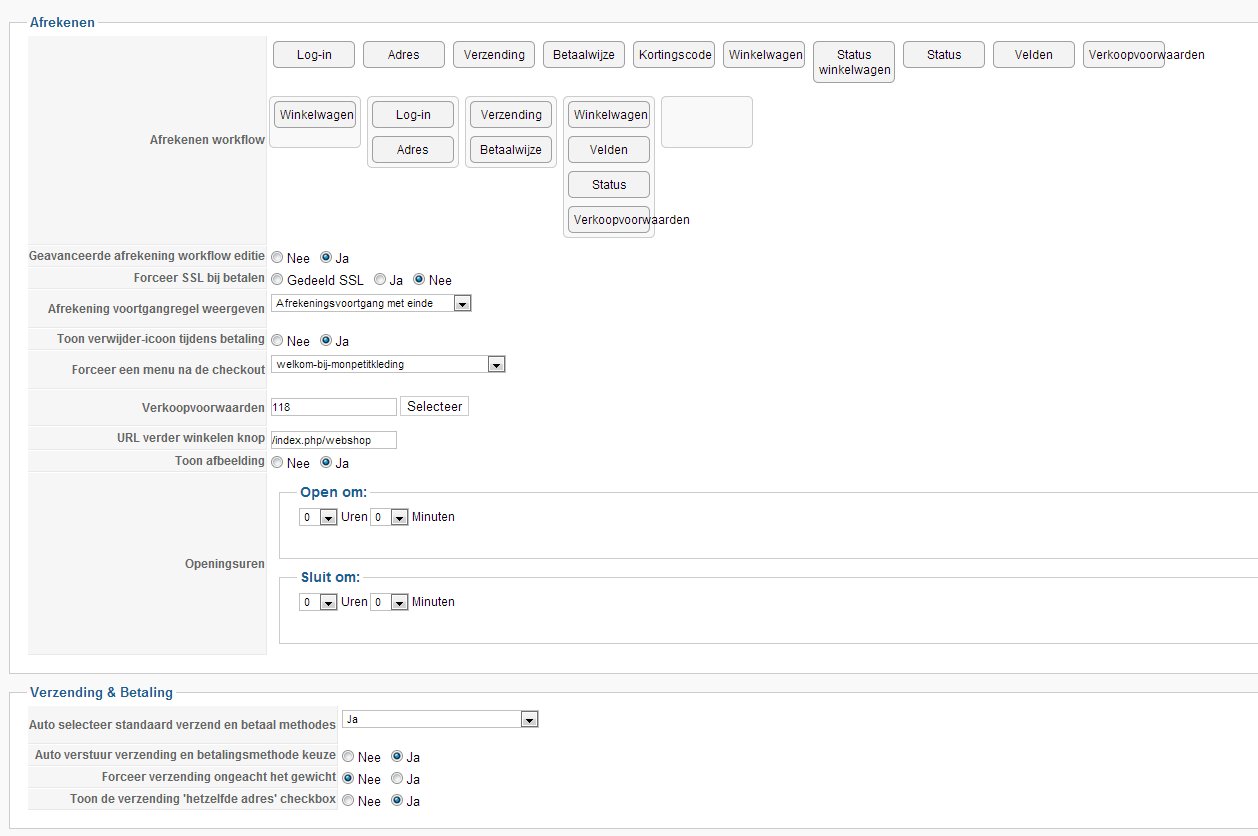

  • Posts: 106
11 years 5 months ago #132596
I don't understand you question.
How can I implement the "Thank you page" or is it "standard "implemented in the checkout or is it part of the payment plugin of hikashop.

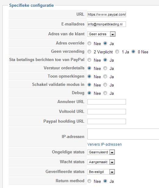

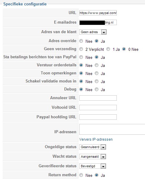

I attached the checkout and paypal screen dumps.
Maybe the problem is that I don't understand the checkout/payment process of Hikashop in combination with GA.
I hope you can help me with this and solve the problem.
Thanks For your time.
Best regards, Gerard
