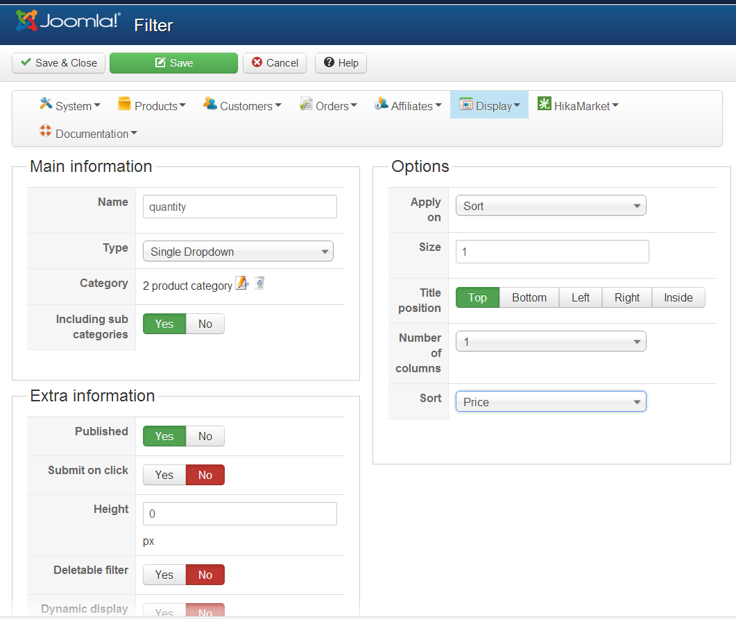

2. There is no "price_percentage" value for filters. You must be mistakening it with something else. Here is how a price sorting filter should be configured:
3. It is not possible for now to sort by price by default a products listing. That can only be done via a filter.
That's because sorting by price is much much more complex than sorting by another column as the taxes/discounts, etc cannot be calculated on the fly and thus would require a precalculation mechanism as I have said in my previous message.
