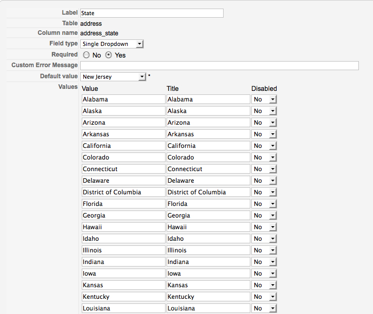

Great, thank you! I applied regular NJ State and NJ state is within country United States of America, so that should be fine, but it still displays taxes for every state.
I created a new single dropdown field for state in the address submission, so I have all of the states listed. Maybe this is something that is not working correctly.
It displays fine when I choose the state in checkout, but when I get to authorize.net page, it shows my billing address without the state.
Do you think the custom field might have something to do with this?
Please see attached is a screen shot.
  • Posts: 83604
  • Thank you received: 13536
11 years 11 months ago #100697
Yes, that's definitely the problem. You should not change the field type of the address_state custom field because otherwise, the system won't be able to link the value in the address with the zones in HikaShop and thus with the taxes...
