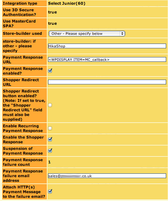

The settings at WorldPay haven't been changed:
As the call-back isn't being made then the order remains at a 'Created' status and is having to be manually moved to 'Confirmed'.
