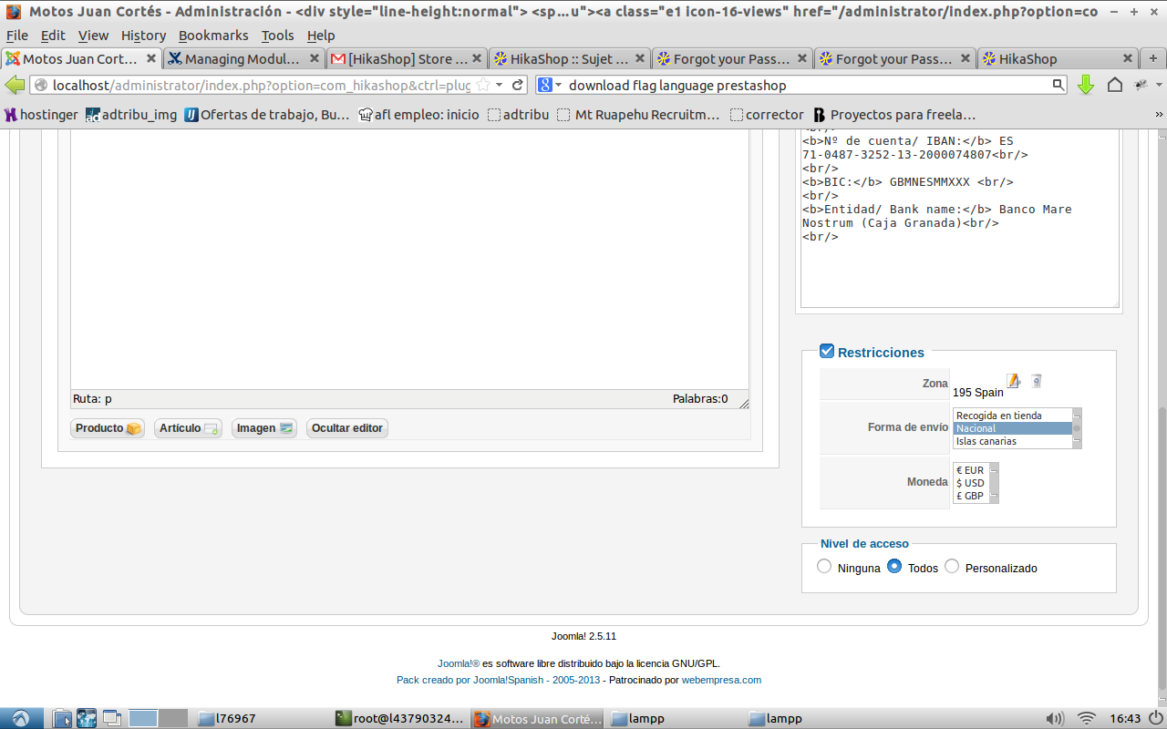

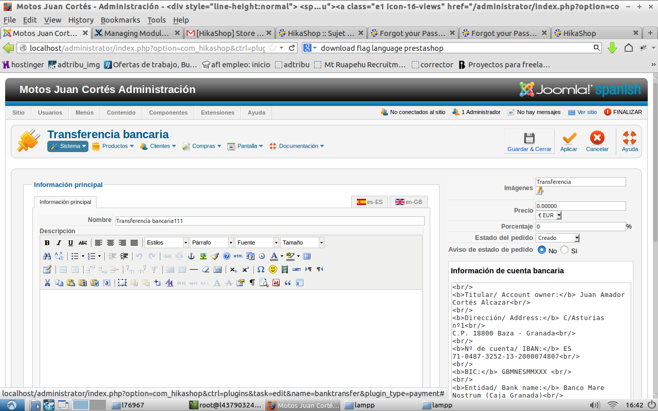

11 years 11 months ago #104199
when i tried to add a zone restriction in,
Hikashop Bank Transfer Payment Plugin or Hikashop Bank 2 Transfer Payment Plugin
then it stop showing in the select form.
First it shows Transferencia bancaria111, then nothing.
In the credit card plugin it shows without a problem.
Where can be te problem? thanks

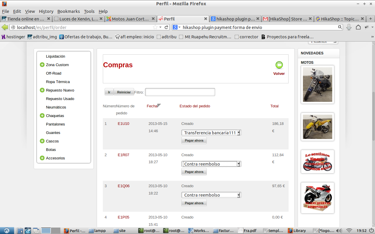

11 years 11 months ago #104240
when i add a zone restriction in,
Hikashop Bank Transfer Payment Plugin named Transferencia bancaria111,
something weird happens,
it stop showing in the orders(compras) page. in the picture i ve send, the number 1.
Bank transfers payment plugin can t manage Zones restrictions?

  • Posts: 14
11 years 11 months ago #104348
it happens the same width the HikaShop check payment plugin
  • Posts: 83746
  • Thank you received: 13552
11 years 11 months ago #104373
Then it probably means that you user address is not in Spain.
