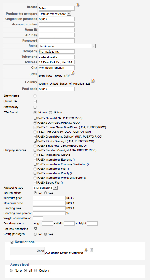

  • Posts: 43
11 years 11 months ago #102725
Hi Jerome,
Are talking about FedEx here or UPS.
I see no field for residential or commercial type address in my FedEx plugin that came with Hikashop extension (see attached image).
Also when I go to documentation/integrated documentation, I cannot find anything about FedEx plugin only UPS.
Also shipping option: FedEx Ground is not working for some reason, only Fedex Ground (home delivery) is. Is this a plugin bug?

  • Posts: 43
11 years 11 months ago #102846
Ok, please see attached is a screenshot of the FedEx plugin configuration. Again this is the site: 50.97.105.145/~mandecki/index.php/products

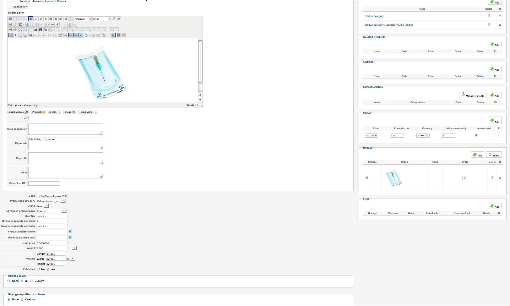

For products (the weights and dimensions vary) for example:
1) p-chip mouse injector (100 units) has weight: 3.5 lb and dimensions: 24 X 12 X 12 in
2) p-chip mouse injector (1000 units) has weight: 26.5 lb and dimensions: 18 X 18 X 18 in
How do I make sure I sent the weights and dimensions for the products I am using? I thought that this was automatically done through the plugin and sent to FedEx.
I also have the most recent version of Hika, which is 2.1.3
I don't have characteristics for the products, just the weight and dimensions, please see attached screenshot of a product page configuration.
Thanks you!
  • Posts: 83604
  • Thank you received: 13536
11 years 11 months ago #102858
I see several potential issues here:
1. You restricted the plugin to the USA which means that if you're address of the customer is outside the USA, it won't see the rates.
2. You checked the "use box dimensions" checkbox which means that the plugin will use the dimensions that you specified in the "box dimensions" fields. As you didn't specify anything there, it won't work properly. Please uncheck that checkbox.
3. You selected only some shipping services and based on the products/address of the customer, some services might not be available and thus not display on the checkout.
The rest sounds good to me.
