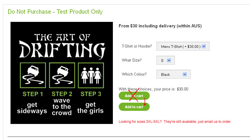

I would like to move the Add to Cart button on my product listing down to create a space between the PRICE_WITH_OPTIONS text. Could you tell me how to do this?
Also, is it possible to add a line of text under the Add to Cart button? I would like a single sentence as in the screenshot attached.
Thanks very much for your help.

Thanks for the info Nicolas, I have set up a product using options instead of characteristics as a test, and it seems to almost do what I want. Much better than previous efforts anyway!
Could you tell me how to move the add to cart button and add the text, as in my earlier post? Thank you.

You can edit the file "quantity" via the menu Display->Views and add your text at the end and <br/> tags at the beginning for that.

I don't really understand, sorry I'm not a programmer. I know the file you are referring to, but could you detail exactly what I need to add and where within the file to put it?

I already told you exactly what to add and where :

And how will that move the add to cart button down?

I have added the line of text, and the add to cart button is now very cramped.
Could you please explain how to add space above and below the button? If it's not too much trouble.
Thank you.

The <br/> tag is a HTML tag which is used to add spaces between other HTML elements, so if you add it at the beginning of the quantity file as I said it will increase the space between what is before and the button.
You can also add one before your text at the end to add a space between the button and the text.
