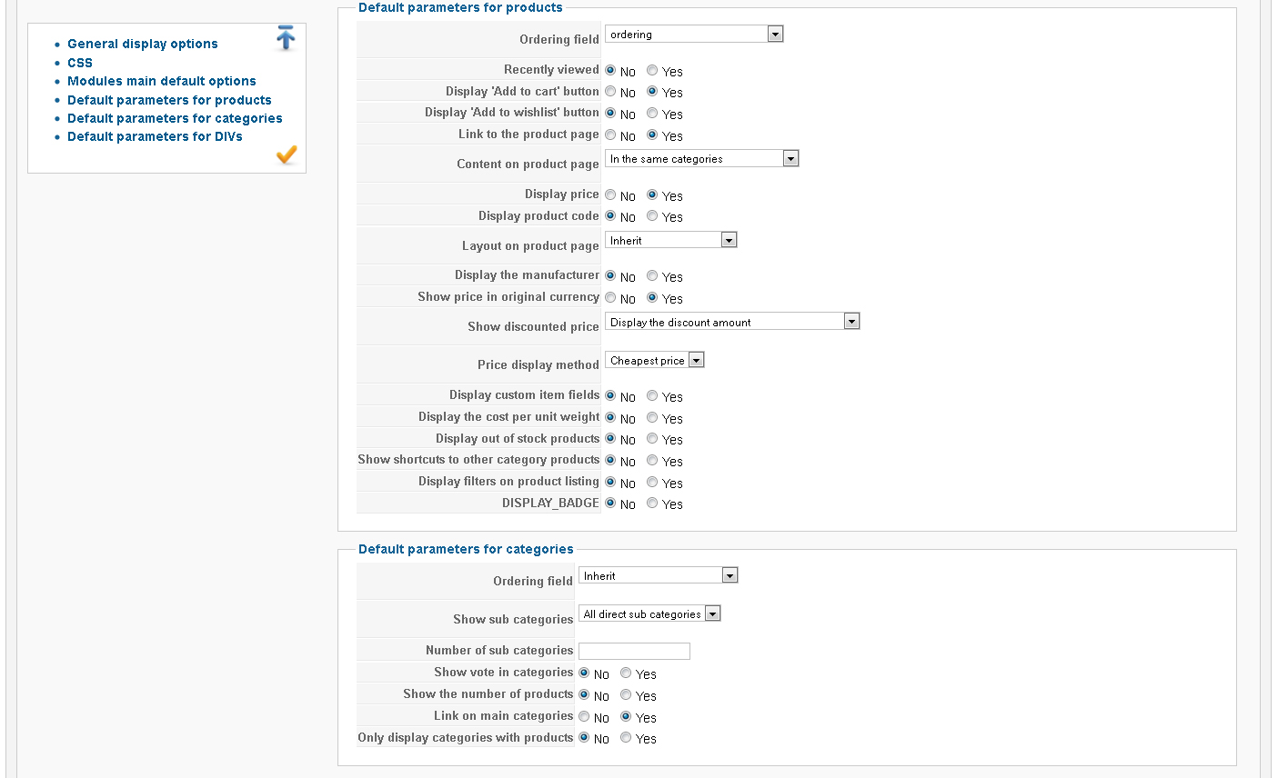

What am I overlooking? What do I need to do to set this tabular layout?
Screenshot attached
Sjaak

11 years 11 months ago #105012
There is the "layout on product page" option right in the middle of your screenshot...
You should set it to "default".
You will have the same option in each category and product edition page and in should be set to "inherit" in all of them.

11 years 11 months ago #105032
I followed your instruction and changed this "layout on product page" option to default. Gee, somebody tells me about tabular layout and that was what I was searching. No wonder I couldn't find it.

11 years 11 months ago #105230
Thanks, now the account works.
Problem was that, you had a in your main configuration the layout "inherit" configured.
This value is not accepted by the system because it can't inherit from a higher configuration. This value should be not "selectable", we will fix it.
