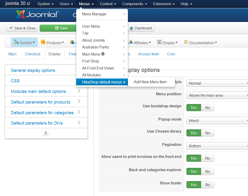

HikaShop default menus are available via the joomla menu manager:
If you want to create you own categories listing menu items, I invite you to read our documentation on that:
www.hikashop.com/en/support/documentatio...splay-front-end.html

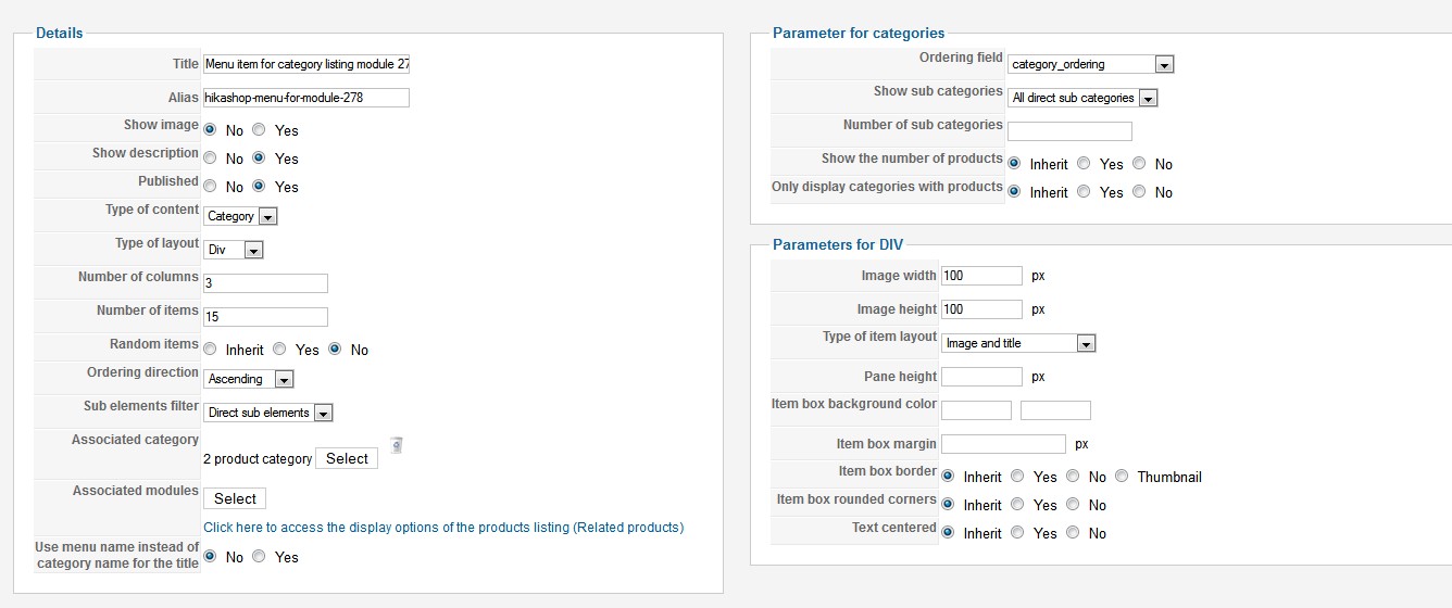

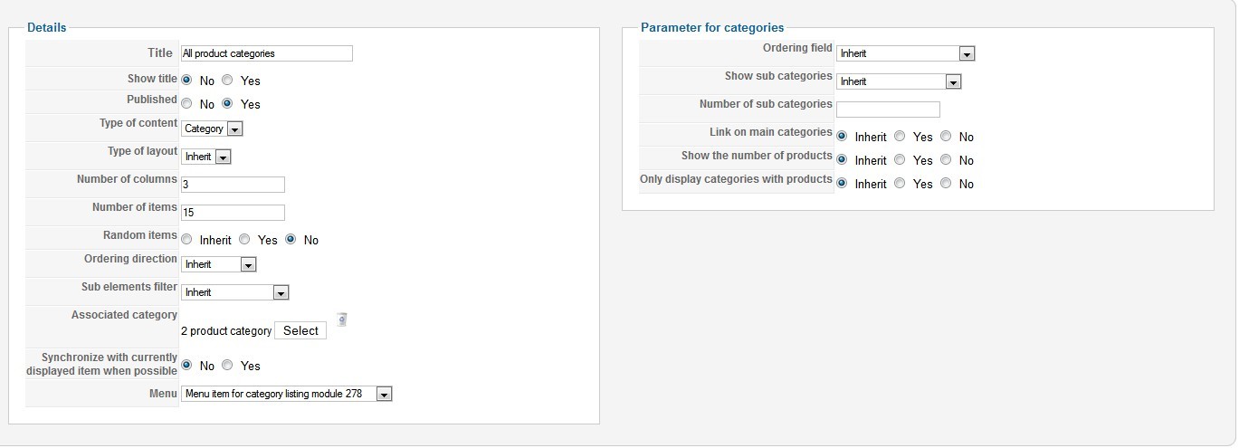

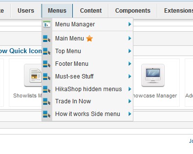

Thanks, nicolas. However, I only see hikashop hidden menu instead of "default menu" you refer to. Are they same?
As I mentioned before I point the menu option of my category module to one of the hidden menu but it didn't work. Could you please check what is wrong with the following configuration and let me how to fix them?
So you think its best to create a category with menu first, then point the menu option in the new category module to that menu?
Thanks again,

The hidden menus is something else.
If you don't have the default menus it means that either you're using an old version of HikaShop or that you installed an old version of HikaShop and updated later on and thus you didn't get them inserted as they are only added for new installs of HikaShop since we added them in HikaShop.

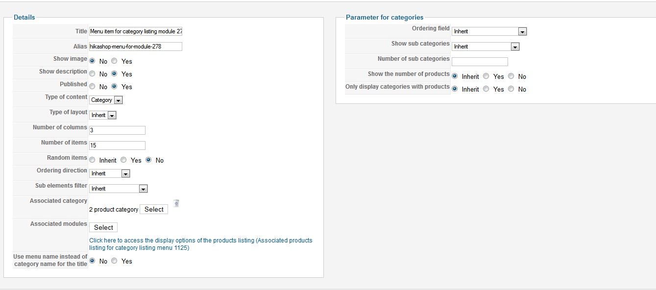

Thus, you will have to create yourself a category listing menu item and select it in the "menu" option of a category listing module instance that you would create to get your categories listing module. Both categories listing menu item and categories listing module instance creation are explained in the link I gave in my previous message.
In your screenshot the settings are correct expect for the associated module: You're using the related products associated products listing module instead of a standard one so it's probably not configured to do what you want it to do.

Follow the documentation on the creation of a categories listing menu here:
It explains how to generate a standard products listing associated module.
