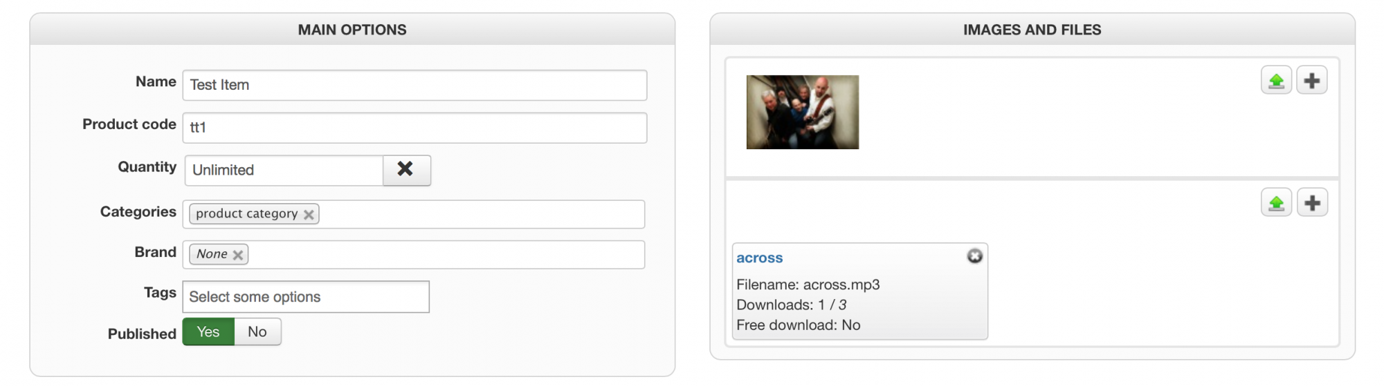

Can you please provide a screenshot of your product configuration (the file section at the bottom right) ?

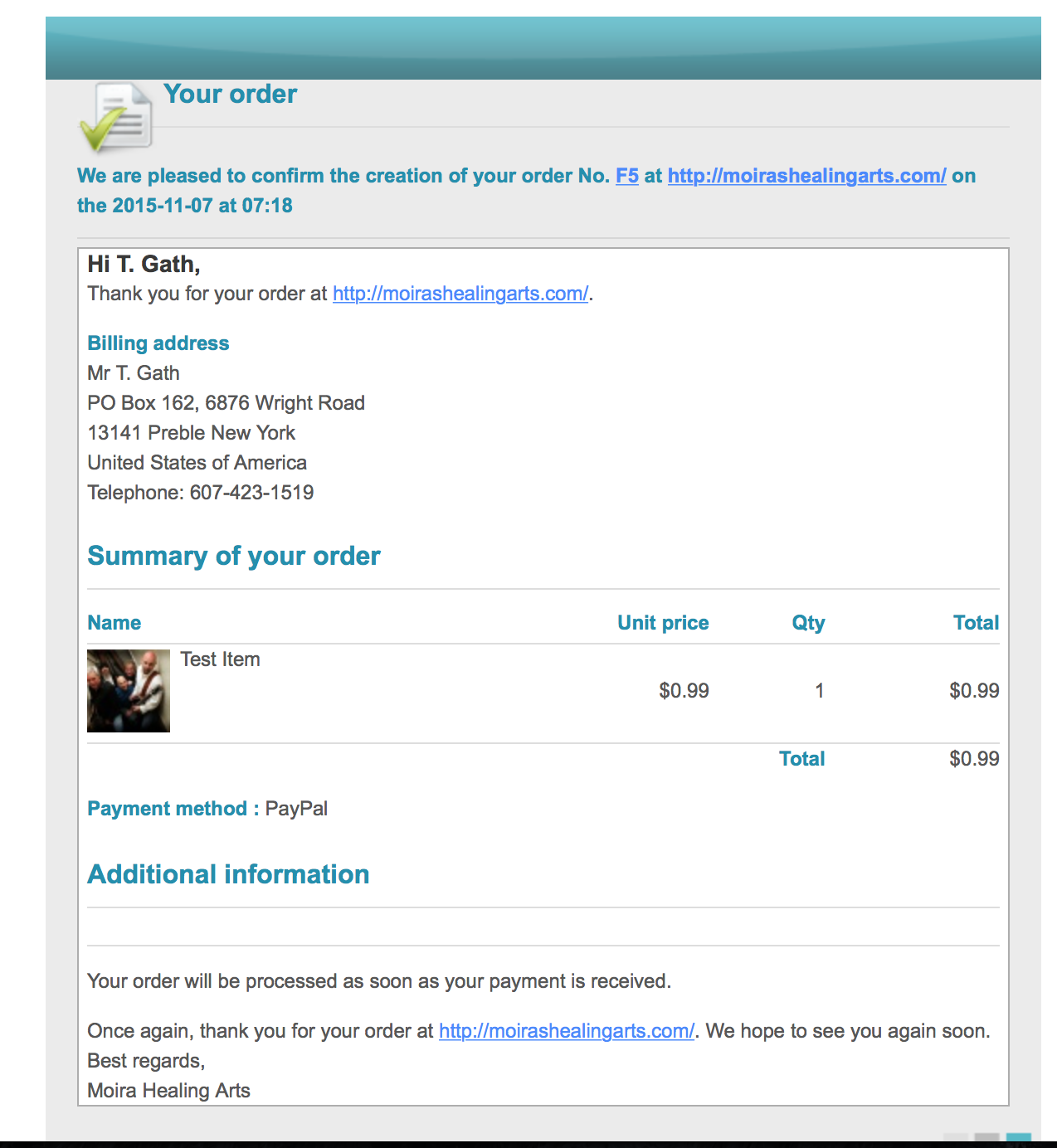

Attachment1: File section of the Product Configuration
The order is NOT automatically confirmed when payment is received.
Attachment 2: The order status notification email

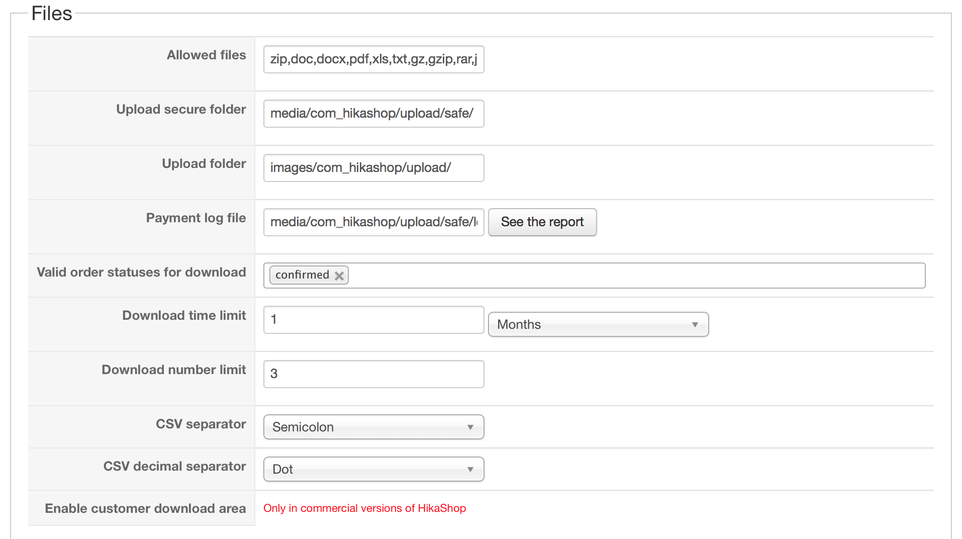

I noticed that there are no conferment payments in the payment log file so I have added an additional Screen Shot: File settings from Order Config page.
Last edit: 9 years 4 months ago by tgath. Reason: Adding a screen shot

So you didn't give a screenshot of the order status notification email (which is sent after the order is confirmed) but a screenshot of the order creation notification email (which is sent at the end of the checkout).
The issue is that HikaShop doesn't receive payment notifications from the payment gateway and thus it cannot allow the customers to download the files.

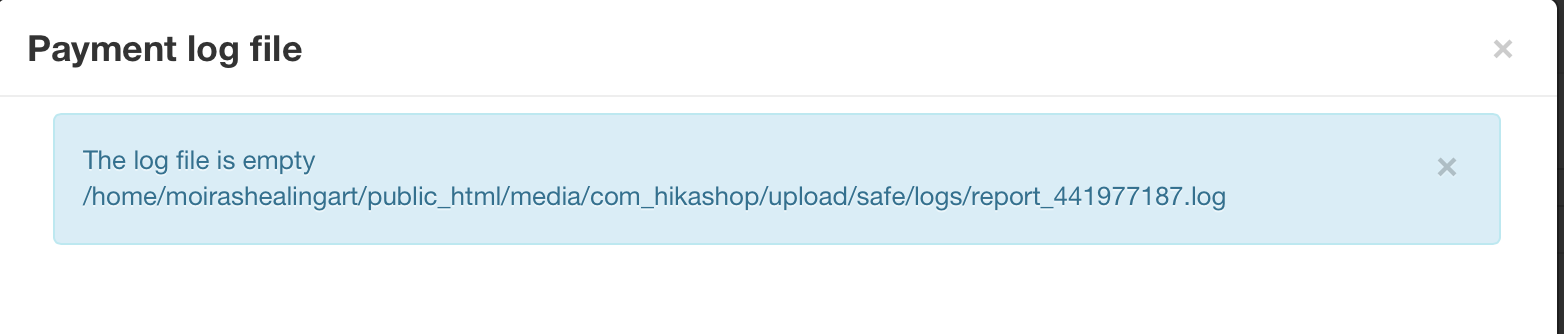

The Payment Log file is in the screenshot attached below.

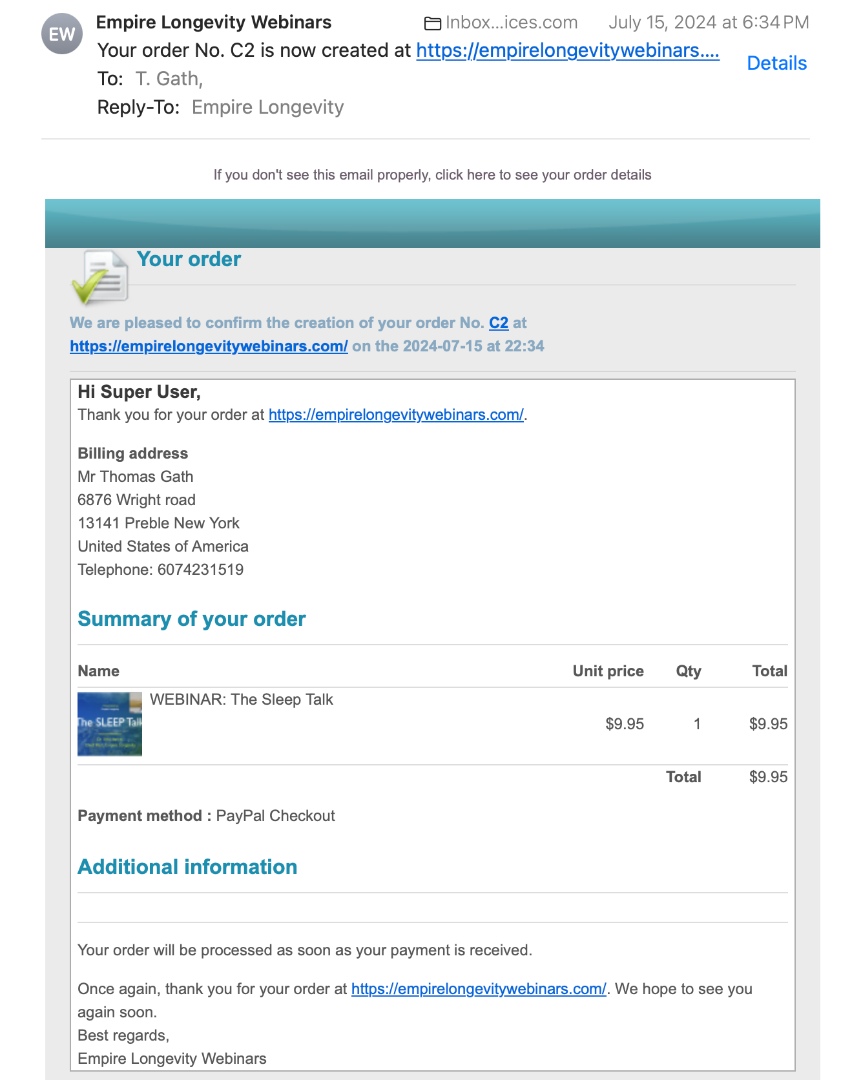

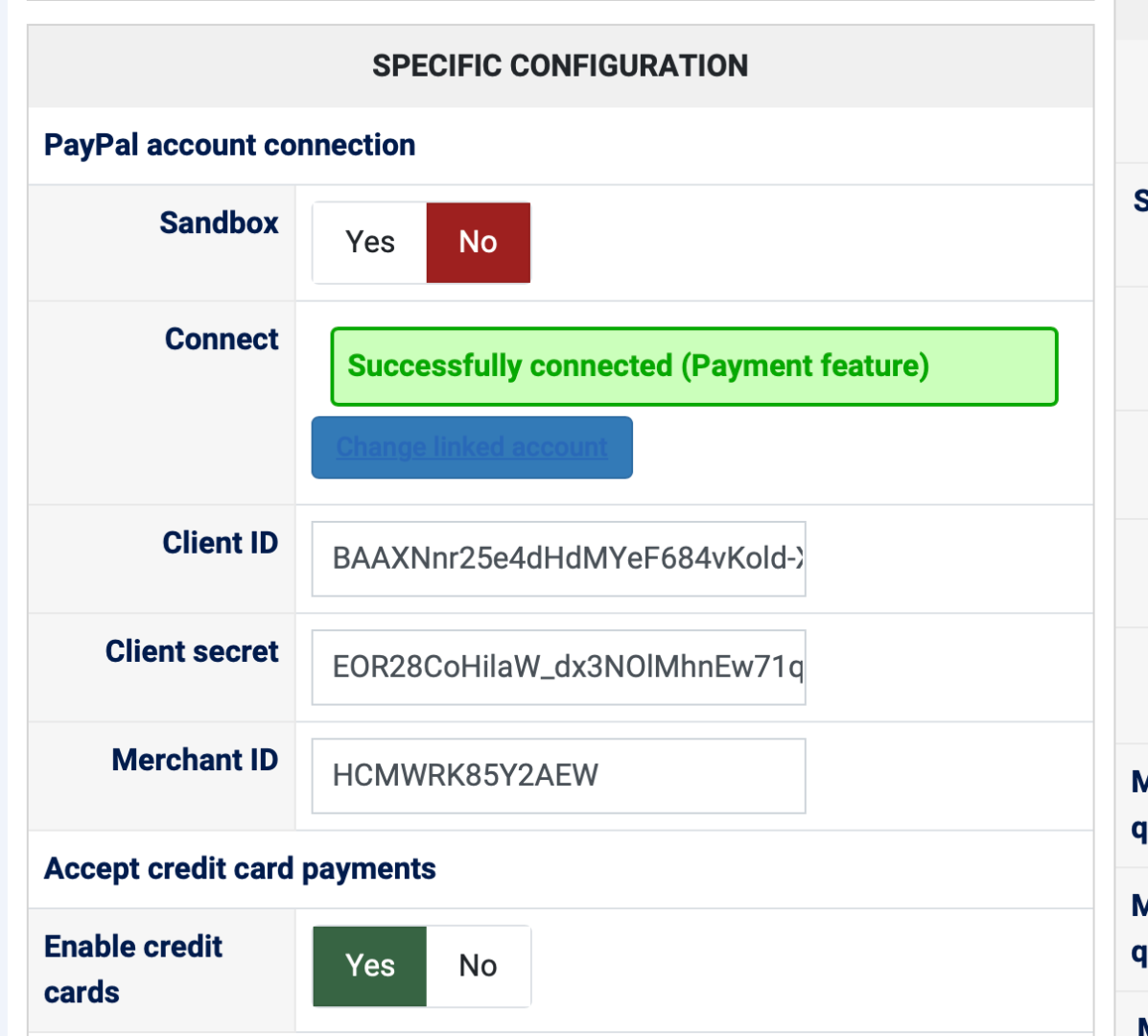

Thank you for your reply! So I am using Hikashop Starter 5.1.0 with the PayPal Checkout plugin that comes with it. PayPal is configured successfully (see screenshot) I have also attached a screenshot of the email that I received after purchase.
To step back, What I am trying to do is have a customer pay and then have videos available for them to view. If a 'view link' isn't possible then a download button would be my second choice. I will appreciate any suggestions that you have to help me accomplish this.

This is the email sent when the order is created. HikaShop sends a second email once the order is confirmed, after the payment. And the download link should be in this second email.
