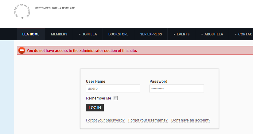

I cannot for the life of me figure out why user registration doesn't work. The activation link does get sent properly. But when I click on it, it takes me to a nonfunctional login page. When I log in, I get this error message: "You do not have access to the administrator section of this site." Yet in the user manager of Joomla I see the new user and username. The new user has in fact been created but for whatever reason user login will not work. This new user is a public user with no special privileges. When I log in as a registered user, everything works fine. The discounts are showing as they should and I can check out normally. I hope you can shed some light on why public users can't register and log in and buy products just like site members (minus the member discounts of course). If you need to take a quick look at my settings, I would be happy to provide back-end access.

11 years 10 months ago #107664
For future reference in case anybody is monitoring, this approach did finally work except for a final step I missed. Hiksahop customers are directed to a custom Joomla user category called "Nonmembers." "Nonmembers" was properly endowed with a "registered" access level. The step I missed was in the site's Global Configuration settings. There, in the Permissions tab, I had to customize the settings for "Nonmembers." Specifically, "Nonmembers" had to be permitted to log into the site. This was what had tripped all the error messages.
So now, I have my working system which allows members to log in and claim their membership discount. Public users can shop the store by creating a Hikashop customer account and paying full price. Both groups can purchase downloadable digital products.
