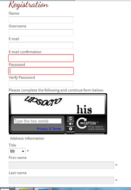

11 years 10 months ago #108108
Yes I know that is what SHOULD be happening but the login and address are both appearing on the same page with the recaptcha in the middle! This is what I am trying to resolve. I am sending a screenshot where you see the login/registration followed by recaptcha and then you see the address all on the same page which is not what should be happening.

11 years 10 months ago #108133
We can't see the address fields through your screenshots, but aren't you talking about the address information that are into your registration form ?

11 years 10 months ago #108573
There is no option to do that.
The address fields are automatically displayed on the registration form as they are part of the form itself.
Upgrading won't change that.
And as I already said, the address selection view is correctly displaying on the second step of your checkout (I'm not talking about the address fields of the registration form but the address selection area).
