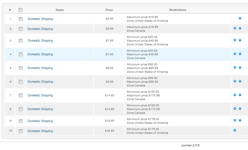

1. This client has a complex schedule of shipping fees based on subtotal ranges. And the ranges apply only to North America (U.S. and Canada). The client's shipping methods fee schedule is attached. Also attached is a screen shot of how I set up Hikashop to match. When I turn them on the Hikashop shipping methods, I believe the cart will automatically apply the right one at checkout based on subtotal. Correct?

1. yes.

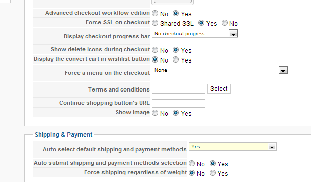

3. Simply do not set a weight in your ebooks and set a weight for the other products and then turn off the option "force shipping regardless of weight" in the configuration.

Regarding #3, are the settings in the attached correct? Regarding #2, in your next version, will shipping methods be able to be applied by category? So much faster and easier.

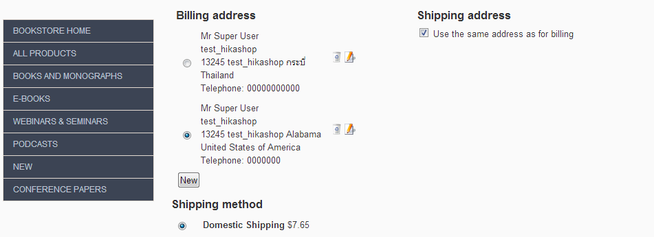

11 years 5 months ago #108932
I check your settings and your checkout and everything is ok.
When I use an overseas address, the overseas shipping method is used, and when I use a US address, the domestic shipping method is used.
See here:
In your message, you talked about having the 35% as an extra on top of the domestic shipping charges.
In that case, you will have to create one overseas shipping method per domestic shipping method and configure each the same expect for the zone restriction (of course!) and the percentage field where you can add the 35% fee for each overseas shipping method.

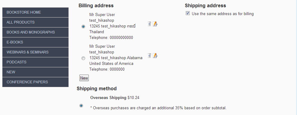

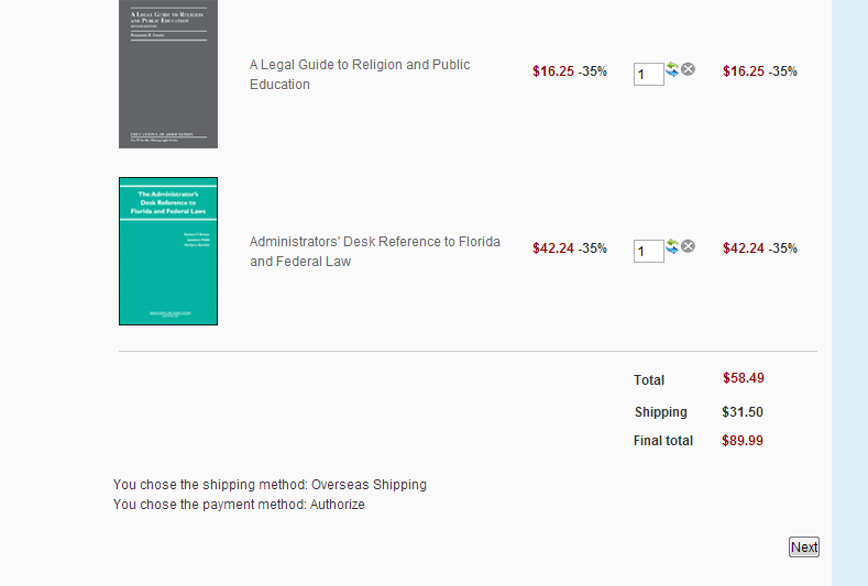

I am worried that it still is not working, because when I make a purchase I am still being charged overseas shipping. I have a U.S. address. My screen shot is attached. Why would my U.S. address be charged overseas shipping when yours was not? Because of this strange variation, I disabled the overseas shipping method again. Meanwhile, I will continue to try to understand your suggestion about more shipping methods.

  • Posts: 82863
  • Thank you received: 13372
11 years 5 months ago #108964
You didn't give the address you used in your test so I can't reproduce. You can see in my screenshot the address I used, and it's working fine for it.
