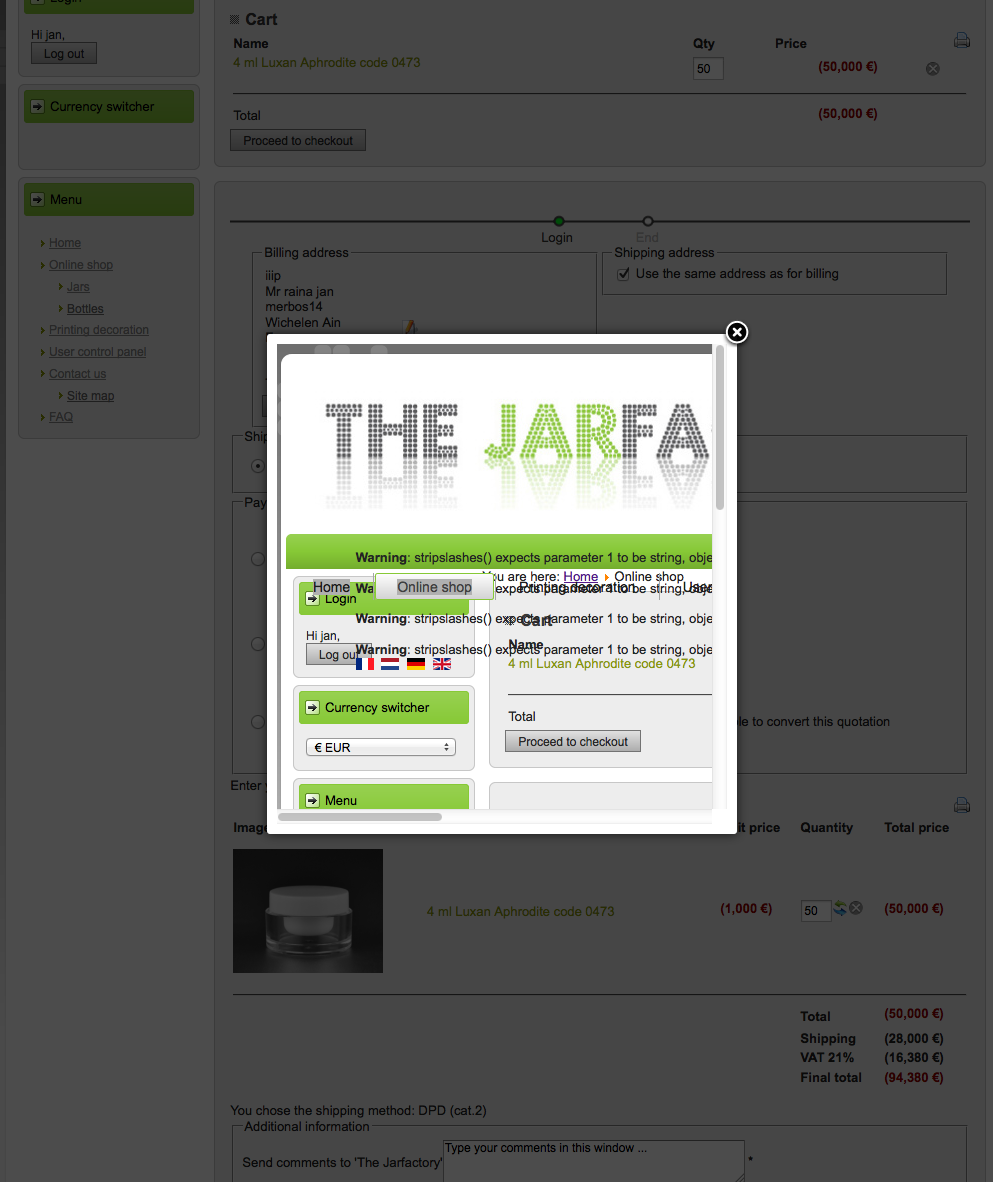

  • Posts: 88
11 years 10 months ago #109981
I guess it is working now...
A new failure showed up now.
When entering an incorrect VAT number I get an error inside the same window (you see the error line + in the background the website) see attached picture
I Have the latest version of Hika 2.1.3
