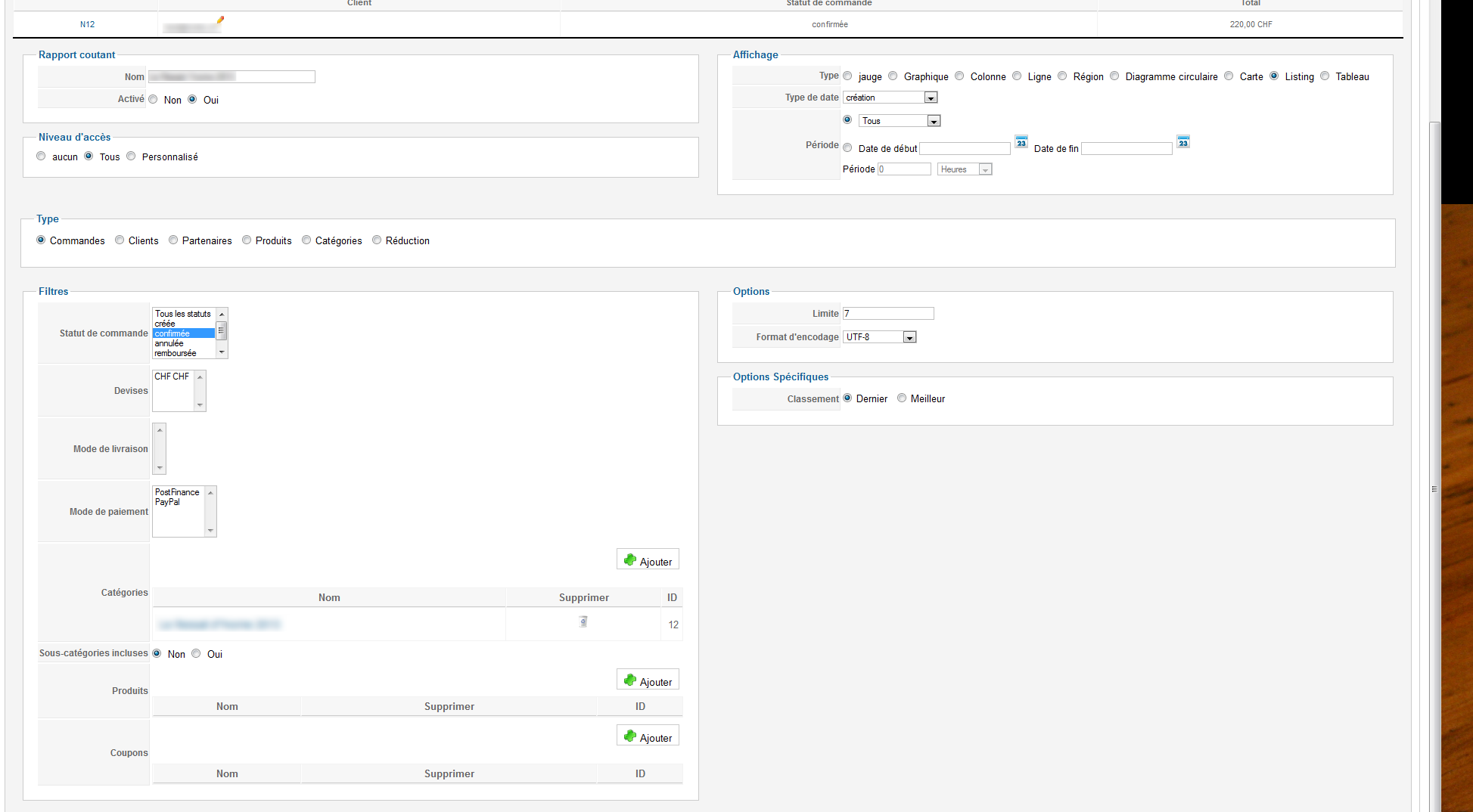

Can you do a screenshot of how you configured the report ?
  • Posts: 30
11 years 10 months ago #110060
Salut Nicolas,
Here is the screenshot
Thanks for the support :)

11 years 10 months ago #110155
Do you have a lot of orders ?
It could potentially come from a limitation of your server which cannot handle all the data that is loaded to fill the CSV if you have a lot of orders and in that case, you would have to see with your hosting to increase the memory_limit and/or max_execution_time of your PHP.
