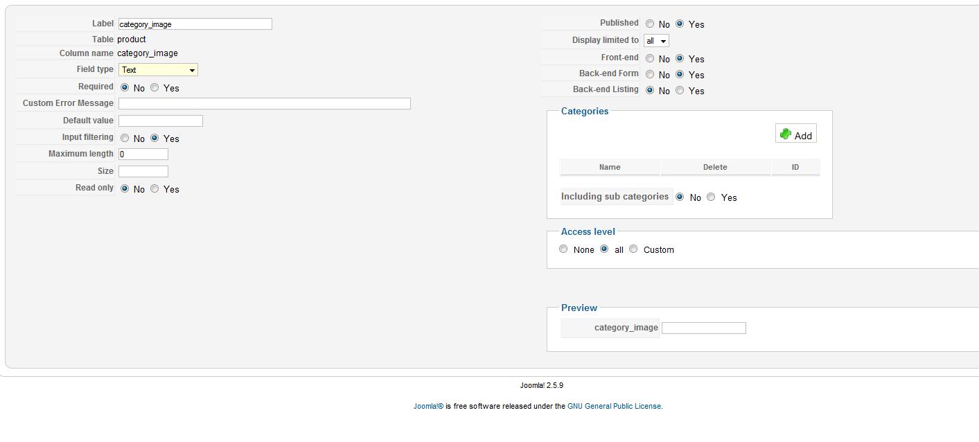

Attached are:
show_default php file
screen shot of the custom_fiel "category_field" configuration
Here is the link to the Product Page: universal-spirit.org/joomla/index.php?op...-north-cd&Itemid=278
Please accept my apologies for my stupidity and thank you for your time and effort.

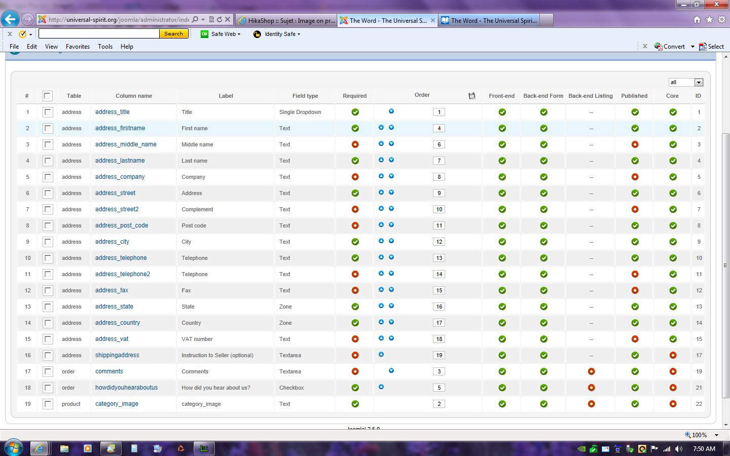

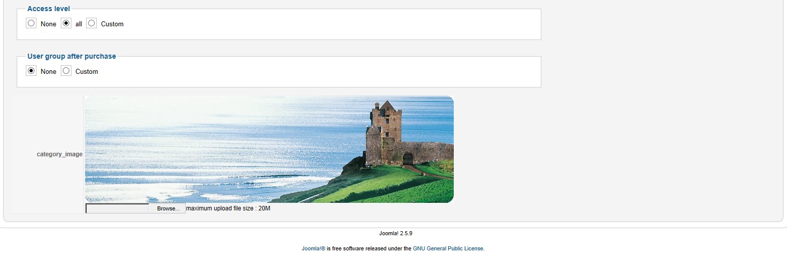

  • Posts: 32
11 years 9 months ago #111810

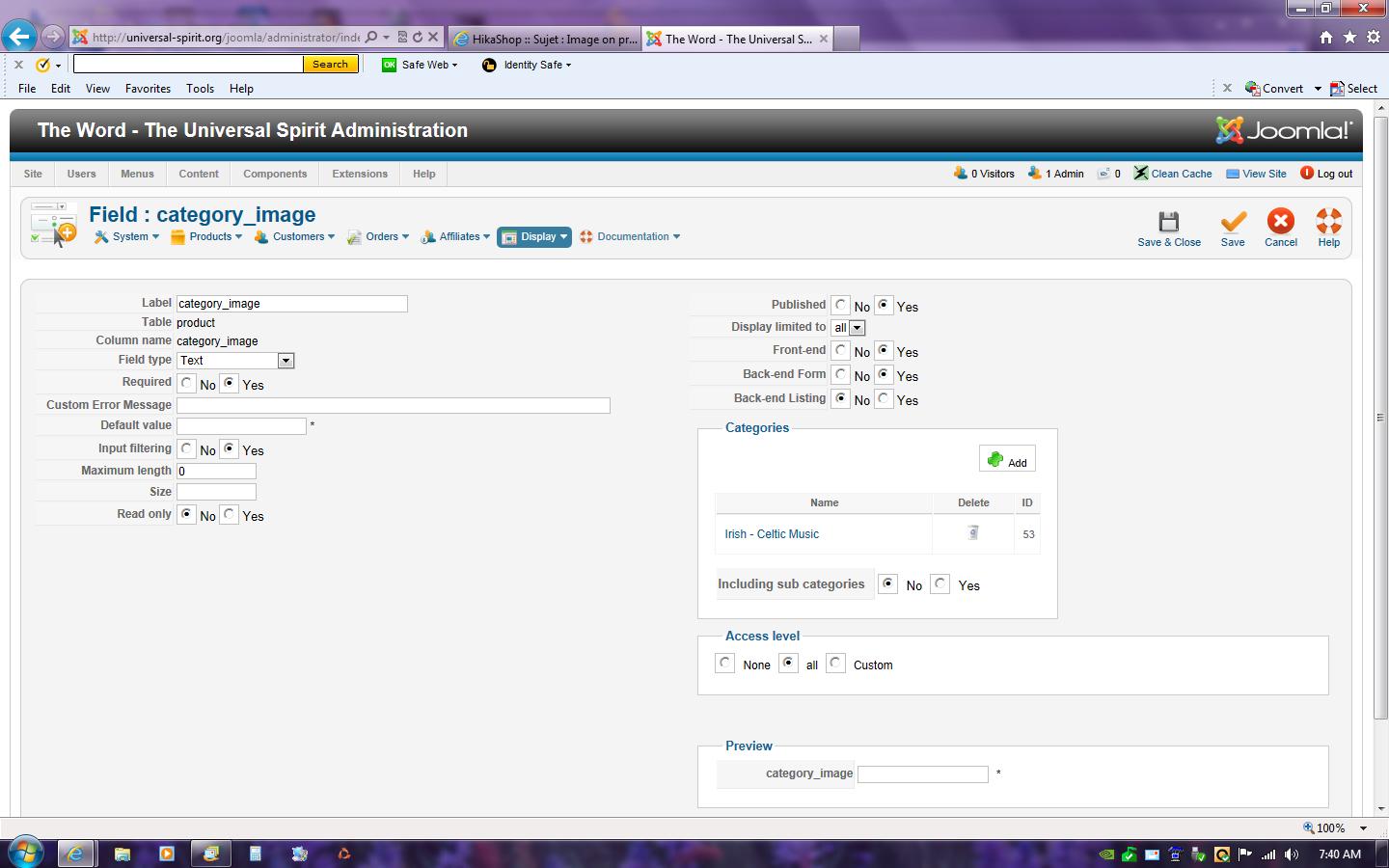

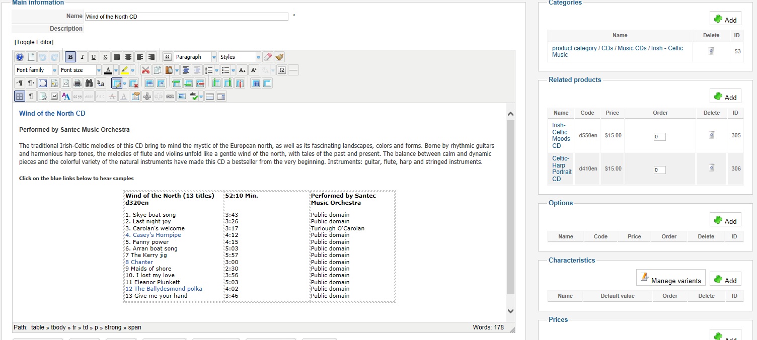

Thanks for your help. The image is still below the product name. And now I get the image filename (irischbanner.jpg) in place of where I would like the category image.
I am attaching snapshots of the product edit screen and product custom field.
Here is the link to the product page: www.universal-spirit.org/joomla/index.ph...-north-cd&Itemid=278
File Attachment:
File Name: product_sh...ault.txt
File Size:7 KB
Thanks again for your time and effort.
Best regards,
Dennis

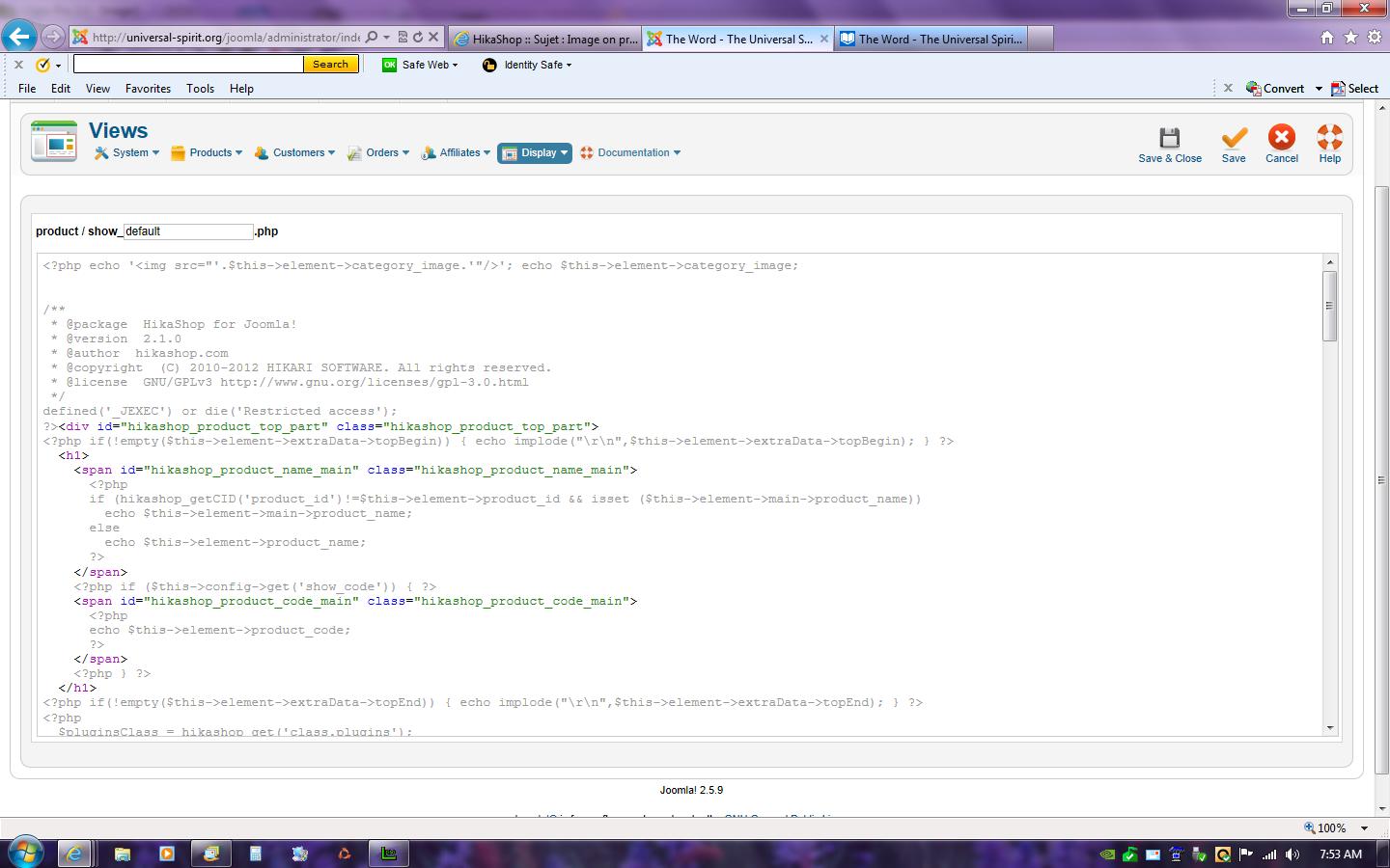

I placed your suggestion in the product show_default and it didn't work. I must be doing something wrong.
Would you please tell me the exact syntax and where to put it?
This is what I put in the product show_default.php
<?php echo '<img src="'.$this->element->category_image.'"/>'; echo $this->element->category_image;
* @package HikaShop for Joomla!
* @version 2.1.0
* @author hikashop.com
* @copyright (C) 2010-2012 HIKARI SOFTWARE. All rights reserved.
* @license GNU/GPLv3 www.gnu.org/licenses/gpl-3.0.html
?><div id="hikashop_product_top_part" class="hikashop_product_top_part">
<?php if(!empty($this->element->extraData->topBegin)) { echo implode("\r\n",$this->element->extraData->topBegin); } ?>
<h1>
<span id="hikashop_product_name_main" class="hikashop_product_name_main">
<?php
if (hikashop_getCID('product_id')!=$this->element->product_id && isset ($this->element->main->product_name))
echo $this->element->main->product_name;
else
echo $this->element->product_name;
</span>
Dennis

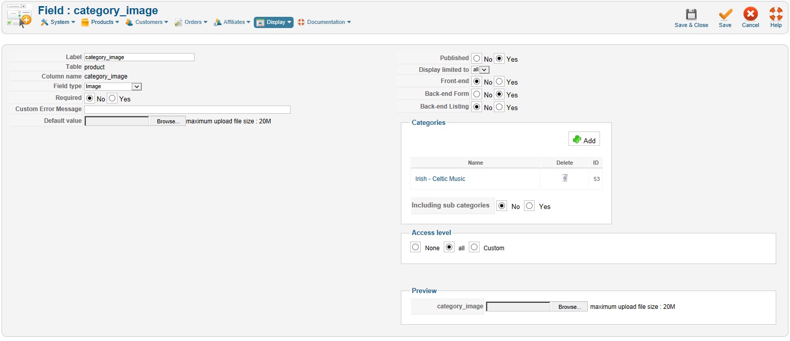

I didn't saw that you used an image custom field. I thought that you were using a text custom field.
Please change the type to "text" for the custom field and enter the link to the image ( www.universal-spirit.org/joomla/images/M...ges/irischbanner.jpg in that case ) and that will work.

  • Posts: 83604
  • Thank you received: 13536
11 years 9 months ago #112006
I said that you need to enter that link in your custom text field in the product edition page.
It's not at the beginning.
It's in fact normally near the bottom of the page that you see your custom fields (you found it when it was of the type "image", so it's simply at the same place).

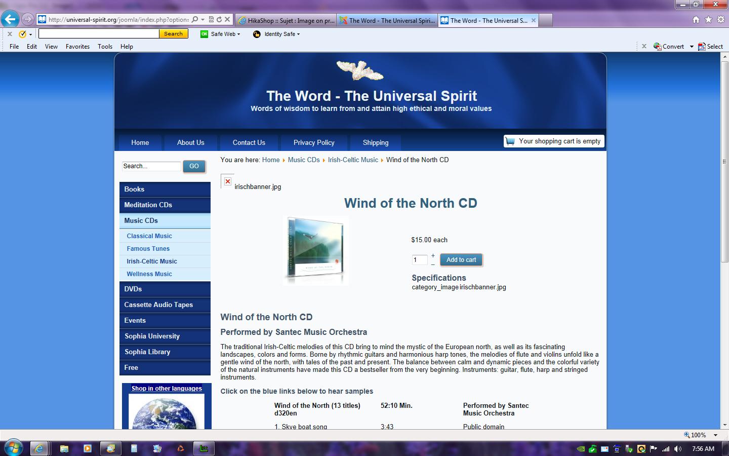

  • Posts: 32
11 years 9 months ago #112134
Hi Xavier,

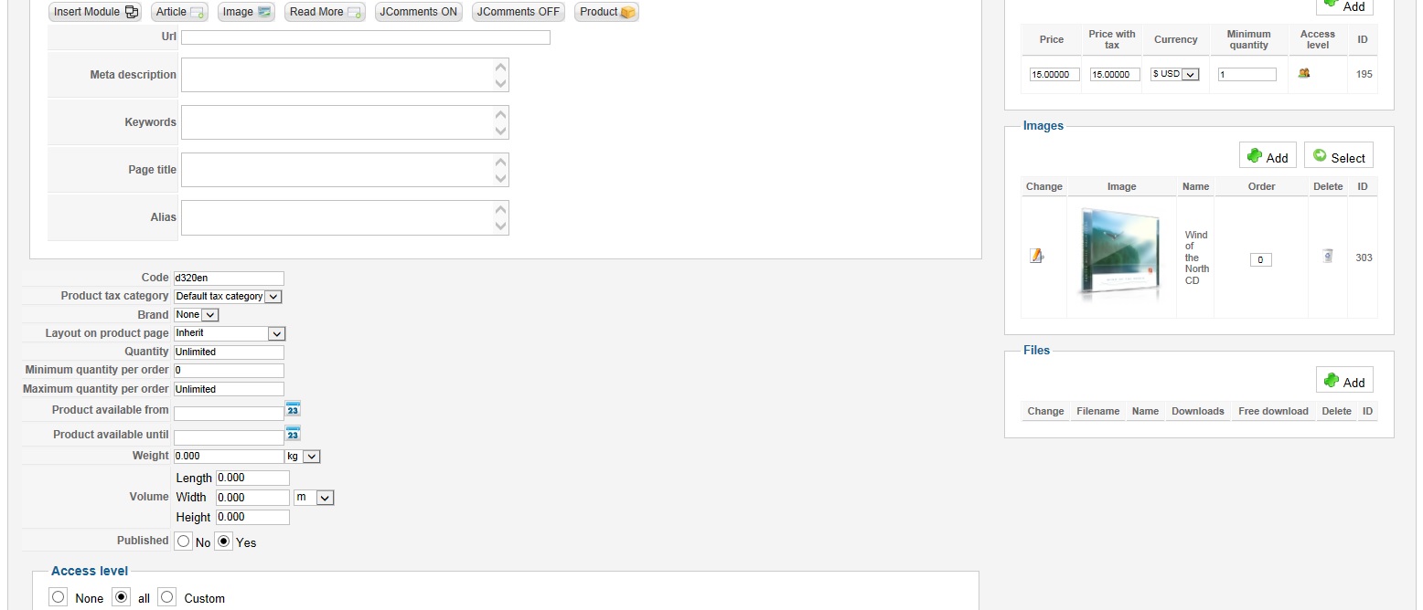

Thank you for your rsponse and suggestion. However, the image still does not show and instead the filename: irscbanner.jpg and an icon shows in its place. Also, the text: Specifications category_image irischbanner.jpg is under the add to cart button.
I've attached four image files and the product/show_default.php file for the template I'm using.
The url of the product page in question is: universal-spirit.org/joomla/index.php?op...-north-cd&Itemid=278
Please let me know if you need further information from me. I look forward to your response and resolution to this issue. Thank you for bearing with me. Your patience and guidance is appreciated.
Kind regards,
Dennis
  • Posts: 32
11 years 9 months ago #112150
I finally figured out how to get the picture between the breadcrumbs and the product name/ add to cart button. How do I get rid of:
www.universal-spirit.org/joomla/media/co...oad/irischbanner.jpg below the image?
Specifications
category_image www.universal-spirit.org/joomla/media/co...oad/irischbanner.jpg
that is below the add to cart button?
Thank you,
Dennis
