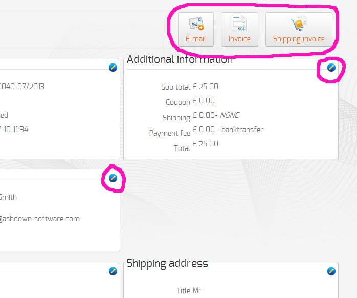

I have just set up HikaMarket and have updated Hikashop to the latest version. My main reason for using HikaMarket was to allow the site owner to manage orders from the front end.
I have provided an admin menu which appears when the site owner logs in and one of the menu items is a link to the Hikamarket control panel.
Within the Control Panel if I select Orders and click on an order number the details of that order is displayed. At the top of the page there are 3 buttons labelled 'E-mail', 'Invoice' and 'Shipping Invoice' and if I click on any of these nothing happens. Also if I click on the edit buttons in the 'Additional Information' or 'Customer' panels nothing happens.

11 years 4 months ago #113282
I see, the problem is the modal popup.
In the HikaShop configuration, you have to change the "Popup mode" in the "display" tab.
Your template is not compatible with the "bootstrap" popup so it will be better to use the "mootools" one.

11 years 4 months ago #113283
Thanks again Jerome, that seems to have done the trick.
