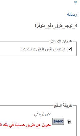

11 years 4 months ago #114219
Last you update 15-7 but after pressing demand to end the show this image note that there is no way to pay, but I can not continue to receive no payment methods available
Note: The problem did not exist in the previous version
Thank you very much

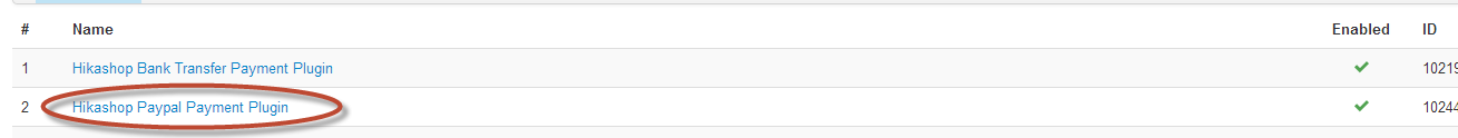

  • Posts: 6
11 years 4 months ago #115361
Problem when adding a second payment method, for example, PayPal does not show the new method?Note it is activated from the control panel and you have to re-install the latest version and the same problem, no payment methods available

  • Posts: 6
11 years 4 months ago #115373
Sorry, you add an additional payment method is PayPal, but does not appear in the road and when you update the latest version to show as the picture in the first post (no payment methods available)
