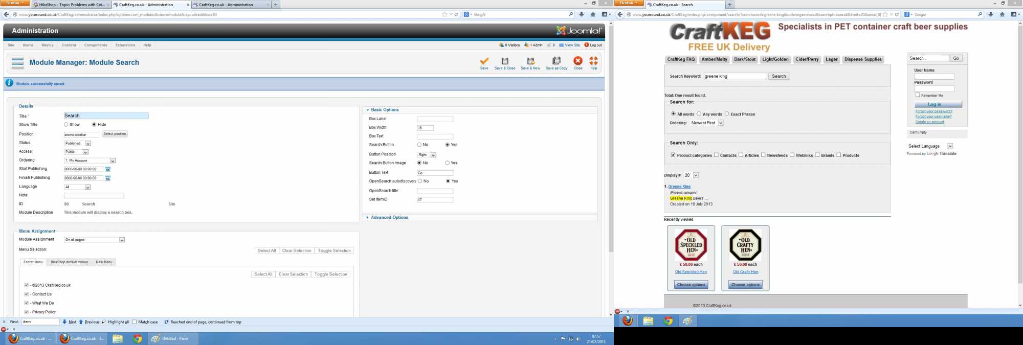

I've attached a print screen of what I'm looking at, which is the options for my search plugin, and the results for doing a Greene King search (the Greene King link goes to the page I showed you earlier which has no products on it)

I said that you need to edit your hikashop products search plugin to configure the itemid option, not to edit the joomla search module.
And I said that you should enter the id of a category listing menu item, not the id of a category. You can find HikaShop category listing menu items via the menu manager of joomla.
Please do that and that should fix the problem.

Thank you, I obviously didn't read the first message clearly as this has worked a charm.
