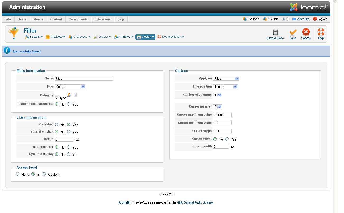

Thanks for that, I've enabled this but it's only brought more problems!
Firstly I've created a cursor filter so people can select the price, but for whatever reason it's not working (as well as creating a massive gap) I also can't put select the filter module as having 2 columns as they appear stacked on top of each other.

About the cursor, first, you set a width of 2px which obviously do not help for displaying it ;)
But the true problem comes from jQuery since you ahve a JS error, it's probably a conflict with mootools, I would suggest to install the Jquery easy plugin to fix that :)

As I said before, you should read the documentation. There is a height option for each filter, just set something higher than 150px (default) and your filters won't stuck anymore.
Same thing for the cursor, I told you to update your Hikashop version since the last version is 2.2.0 while your version is 2.1.2.
We already fixed the cursor issue, just update to fix it.

After spending a certain time, I finally understood your issue.
The point is that your products don't have prices since prices are given to your variants.
Our filters cannot search for variants' prices for now since it's really complicated and the query would be too big.
The solution for you is to set a price to your main product, the same as your cheapest variant for example.
