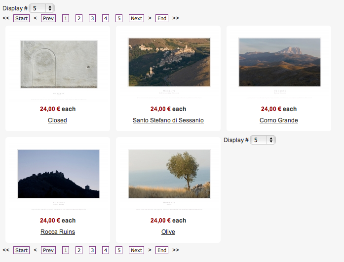

I have edited the file in Views - products - div_listing as described in this thread to achieve having the pagination at the foot of the products as well as the top.
All is good except that the hyperlinks no longer work on either navigation.
I copied the 11 lines mentioned to the very bottom but perhaps I misunderstood:
<?php if($this->params->get('show_limit') && $this->pageInfo->elements->total > $this->params->get('limit')){ ?>
<form action="<?php echo hikashop::completeLink(JRequest::getWord('ctrl').'&task='.JRequest::getWord('task').$this->itemid.'&cid='.reset($this->pageInfo->filter->cid)); ?>" method="post" name="adminForm_<?php echo $this->params->get('main_div_name').$this->category_selected;?>">
<div class="hikashop_products_pagination">
<?php echo $this->pagination->getListFooter(); ?>
<span class="hikashop_results_counter"><?php echo $this->pagination->getResultsCounter(); ?></span>
</div>
<input type="hidden" name="filter_order_<?php echo $this->params->get('main_div_name').$this->category_selected;?>" value="<?php echo $this->pageInfo->filter->order->value; ?>" />
<input type="hidden" name="filter_order_Dir_<?php echo $this->params->get('main_div_name').$this->category_selected;?>" value="<?php echo $this->pageInfo->filter->order->dir; ?>" />
<?php echo JHTML::_( 'form.token' ); ?>
</form>
<?php } ?>
This other issue is where to change the css for the bottom one as at present the first part appears next to the last product if the products do not fill all columns.
I can get the positioning correct if I put the above code in a DIV tag with
styles="float:left;display:inline;"
but perhaps it would be better to include this in a stylesheet.
I've also been struggling to get the Display# and pagination on the same line using css, but perhaps this is something to be done in php?
Your thoughts and advice are most welcome... as always :)

Could you give a link to that page so that we can see what's going on ?
If you want to have the display at the bottom, before the pagination code of the bottom, you should add the HTML: <br style="clear:both;"/>

13 years 9 months ago #8853
The problem is that with both top and bottom pagination displayed, you have two forms with the same name on your page and that is a problem.
Could you try to change the name of the second form to something else in order to avoid conflicts ?
  • Posts: 87
13 years 9 months ago #8887
Yes, that did it, thanks.
Now the only thing left to sort out is getting the two parts of this footer in the same 'row'. I have tried editing the front-end stylesheet but perhaps some of it is created on the fly. Can this be altered in the same php file?
  • Posts: 82863
  • Thank you received: 13372
13 years 9 months ago #8908
You can put the display dropdown and the pagination on the same line with the CSS code:
.limit{display:inline;}
  • Posts: 87
13 years 9 months ago #8934
Thanks Nicolas,
I also added padding to separate it :
.limit {display:inline;padding:0 20px 0 0;}
and this to the stylesheet to center it all on the page.
.hikashop_products_pagination { text-align:center; }
So now it's all complete, just a matter of adding all the products and to do this I'll be buying the business version so I can copy the products as they are all the same sizes and prices... then a bit of testing and my shop is done!
