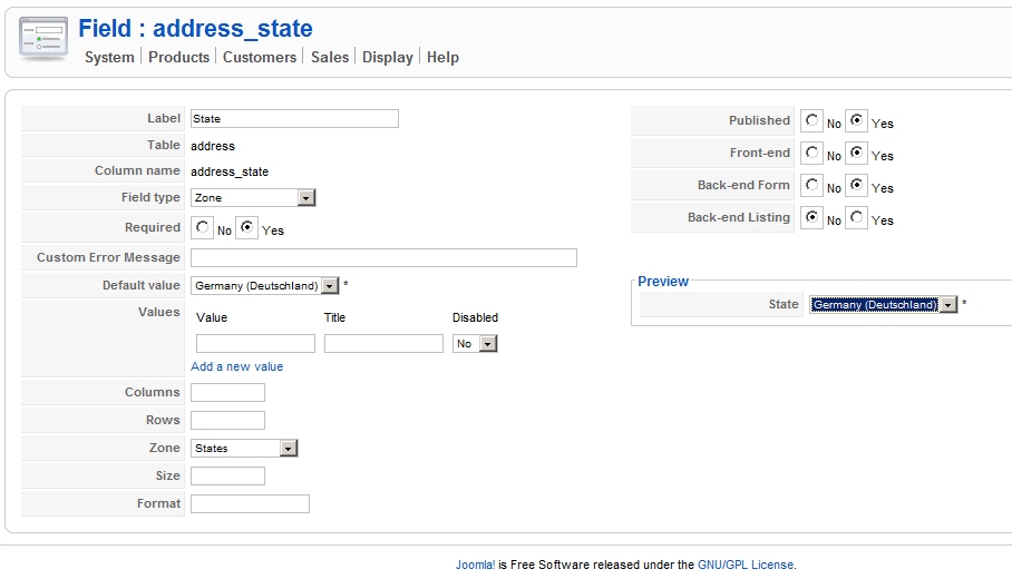

Could you go in Display->Custom fields and edit the address_state custom field and make sure that its zone type is "state" and that its default value is one of the states of germany and save its options and try again ?
  • Posts: 26
13 years 9 months ago #10506
Thanks a lot for your quick answer. I veryfied the zone type, it is state. Pleas watch the attached screen shot.

Please go in Display->Custom fields and edit the address_state custom field and make sure that its zone type is "state" and that its default value is one of the states of germany and save its options and try again. I don't want you to just check the options of the custom field but also save them in order to be sure that the information in the database reflects the reality.
  • Posts: 26
13 years 9 months ago #10516
I double checked it as you suggested. Every setup seemed correctly but I saved the values for sure. And now the state refreshes under IE for country Germany.
