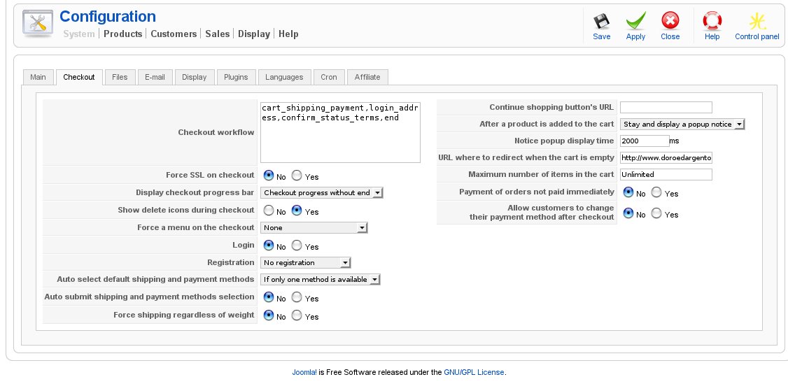

This is my Checkout workflow: cart_shipping_payment,login_address,confirm_status_terms,end
When I'm at step one and click on Next button will charge the same step cart_shipping_payment. Click again on the next button step login_address is loaded.

We cannot reproduce that problem on our end. Could you do a screenshot of all the options of the tab checkout of your configuration ?

  • Posts: 12
13 years 11 months ago #13711
I tried to reproduce the configuration on the demo site and the problem is the same.

13 years 11 months ago #13715
That's because you have the auto select option off and that you're displaying the cart on the same view as the payment methods. So the system displays again the same view in order to confirm the cart changes (later on, the total price might change based on the payment method selection, like it happens now with the shipping).
If you activate the auto selection option or change your checkout workflow, that should solve the problem.
