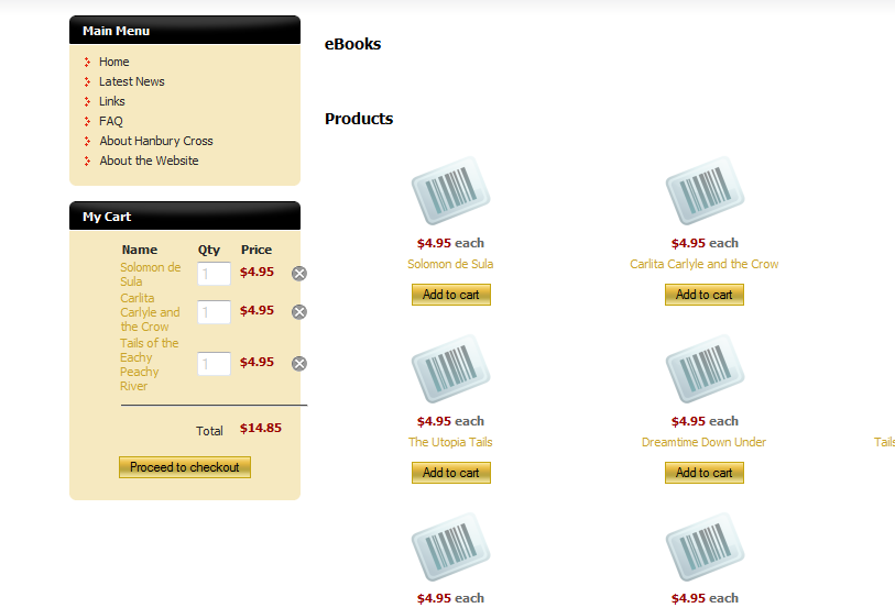

One more thing that seems to be the last one. The Hikashop Cart module's inside alignment is a bit off, see pic.
What would I edit to fix that, is it Joomla or Hikashop specific?
Thanks again.
Last edit: 13 years 11 months ago by panosa73.
  • Posts: 83397
  • Thank you received: 13490
13 years 11 months ago #13900
It's a problem in your template CSS.
You have the code:
div.module_menu div div div div, div.module div div div div, div.module_text div div div div {
background: none;
margin: 0 auto;
padding: 0;
in the file www.hanburycrosspublications.com/templat...104/css/template.css
If you remove the line margin: 0 auto; and refresh your browser's cache, the problem will be solved.
