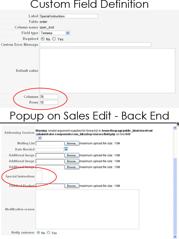

  • Posts: 202
13 years 10 months ago #14157
Thanks for the help!!
Regarding #3:
I set the columns and rows when I defined the field, which is why I was surprised it showed up like it did. I am attaching an image that shows the field definition screen and what I am seeing for that field in the back end. Hope that helps!!!
Rick
  • Posts: 83397
  • Thank you received: 13490
13 years 10 months ago #14162
Ok, thank you for your precise information on the problem. It is now corrected and we uploaded a new version of HikaShop with the fix. If you download and install the latest version, it should now work.
