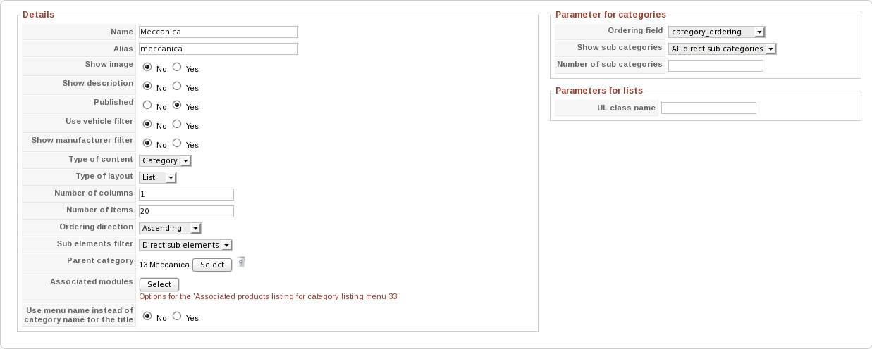

I second this problem. Business 1.4.9. To replicate this problem:
1) create from the Joomla Menu Manager a category list menu entry. Apply
2) Click on the link edit configuration: Add an associate modules and set the configuration in the Parameters for DIV (we set to grey the background)

Anyway we go back to edit the menu entry to modify the Parameters for DIV, but this option is not longer visible. See attachment.
Very strange. The only to resolve this problem is to go into the database and the hikashop_config table and cancel the config value for config_namekey 'menu_xx'. You loose all the configuration values for the menu but you can set the Parameters for DIV. Save it and re-enter again and it is not there to modify again.

  • Posts: 272
13 years 11 months ago #14932
Okay further investigation has revealed the problem.
1) Set up two categories 'Parent Category' and 'Sub Category'
2) Put the products into 'Sub Category', don't put any products into the 'Parent category'
2) Create two menu entries
i) Parent Category -> category listing with 'Type of Layout' set to List
ii) Subcategory -> product listing with 'Type of Layout' set to div
3) Configure the module associate with the 'Parent Category' set the type of layout to div and set the background to red
4) Set the 'Parent Category' so you view the category listing. Click on the 'Subcategory Link' and you will be viewing the Module Associated with the Parent Category Menu. No red background because as I said in my previous post the CSS configuration set in the Menu configuration overrides the values set in the associate module. For me this counter-intuitive. Worse still is that if you go back to configure the 'Parent Category' parameters, because you have set the 'Type of Layout' to list you don't the Parameters for div. And you could mistakenly, as I did, believe that you can not the Parameters for DIV. Anyway if you set the 'Type of Layout' to div for second, change the background colour background to red. Change the 'Type of Layout' back to 'list' and save.
Now when you view the associated module the divs are red.
