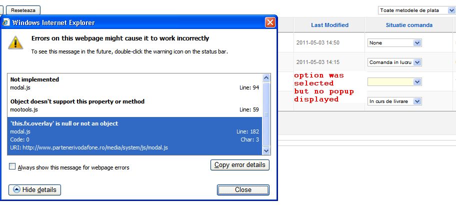

I get this messages when i try to change order status in IE8. Work fine in Firefox 4.
Webpage error details
User Agent: Mozilla/4.0 (compatible; MSIE 8.0; Windows NT 5.1; Trident/4.0; .NET CLR 1.1.4322; MS-RTC LM 8; InfoPath.2; .NET CLR 2.0.50727)
Timestamp: Tue, 3 May 2011 07:49:22 UTC
Message: Not implemented
Line: 94
Char: 4
Code: 0
URI: /media/system/js/modal.js
Message: Object doesn't support this property or method
Line: 59
Char: 102
Code: 0
URI: /media/system/js/mootools.js
Message: 'this.fx.overlay' is null or not an object
Line: 182
Char: 3
Code: 0
I use Joomla Mootools Upgrade plugin which work fine with other applications.
Thank you

We got the access and looked at the order status changer on your website. We could not reproduce the problem. It always worked. We tried on IE8 on both the listing of orders and the order page on your backend and worked all the time without any javascript error with or without the javascript debugger activated in IE. Could you do a screenshot of the page where you have the problem ?
  • Posts: 126
13 years 11 months ago #15613
I tested again using two other computers, same problem..please see attached image

I tried everything I could think of without being able to see the error.
I tried on IE 7 8 9, with the downgrade mode, with IE tester, I tried with the "show debug" option activated, deactivate, with the debugger activated, deactivated and on different computers. I never got that error box so, unfortunately, I'm not able to help you. The only thing I can recommend is to use another browser like firefox or chrome, when administrating your website.
