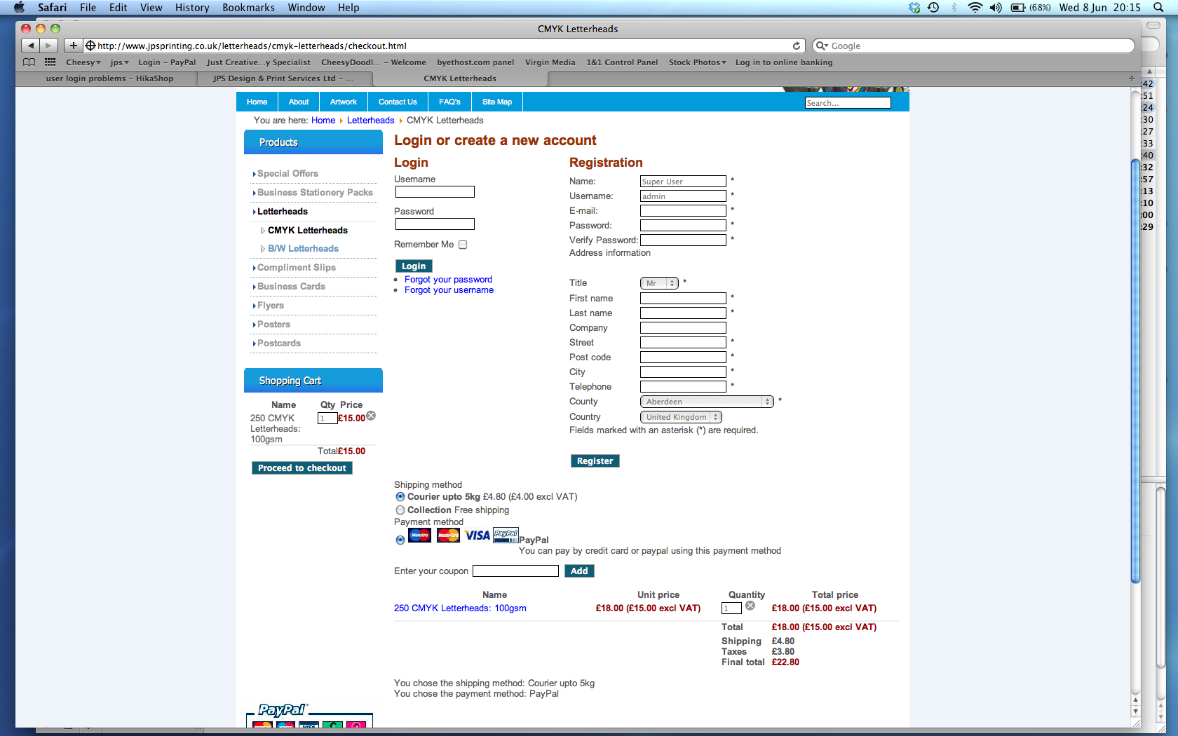

Yes that's correct I am logged in when in maintenance but when I get to checkout I can't get past the login screen (I have attached a screenshot) If I log in on this page it says to create an address or choose one but there are no options to choose an address and when I create an address with the form nothing happens, no error messages it just still says please create or select an address.

The problem comes from the fact that the admin user (that you're using) in hikashop is not linked to its joomla record. You should: delete the orders of that user and delete it in hikashop. Then, logout/login on the front end with that user and hikashop should resynchronize the user and it should work again.
