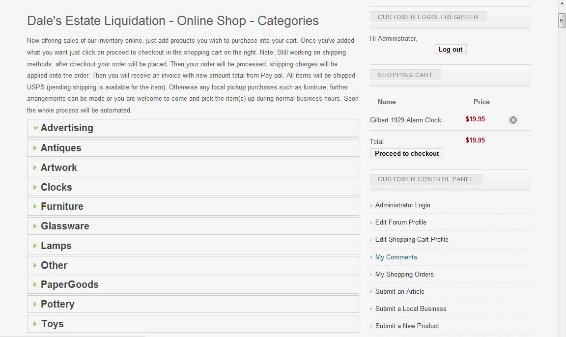

I am having some issues with the cart.
First I added one product to the cart and proceeded to checkout.
Screenshot of checkout
After I click on the remove it takes me to this page which it tells me my cart is empty, but there is another product added to the cart. Plus the categories are gone and it added the products in place of the categories with no pics or add to cart button.
Last edit: 14 years 11 months ago by dan c..
