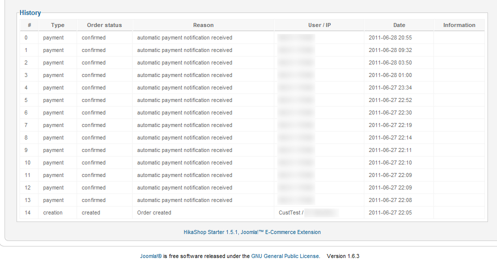

13 years 9 months ago #20129
I am in the process of creating my first e-commerce website using HikaShop. I did a test sale yesterday in order to experience the entire purchasing process. Everything went smoothly but then I (as the customer) received 13 confirmation emails. In the admin area under the Order History it shows "automatic payment notification received" 13 times. I am using the PayPal payment method. Is this an issue with HikaShop or PayPal or something else entirely?
Thanks!

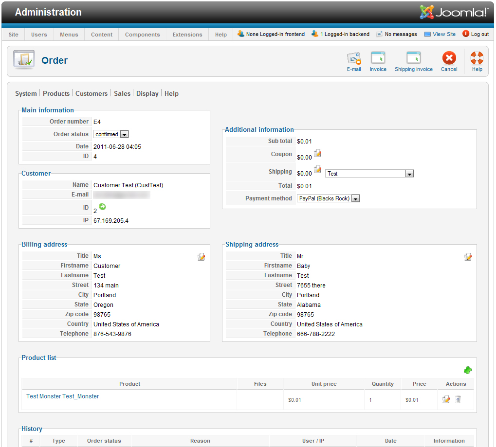

I have attached screenshots of the Order Page, not sure if this is what you were referring to as the notification page. If not- where is that?
Thanks for getting back to me. Here is the top part of the screen:
  • Posts: 9
13 years 9 months ago #20156
Here is the bottom part of the screen:
  • Posts: 83594
  • Thank you received: 13529
13 years 9 months ago #20168
No, what I need is the URL of your shop so that I can order something and see what paypal is seeing for that order.
