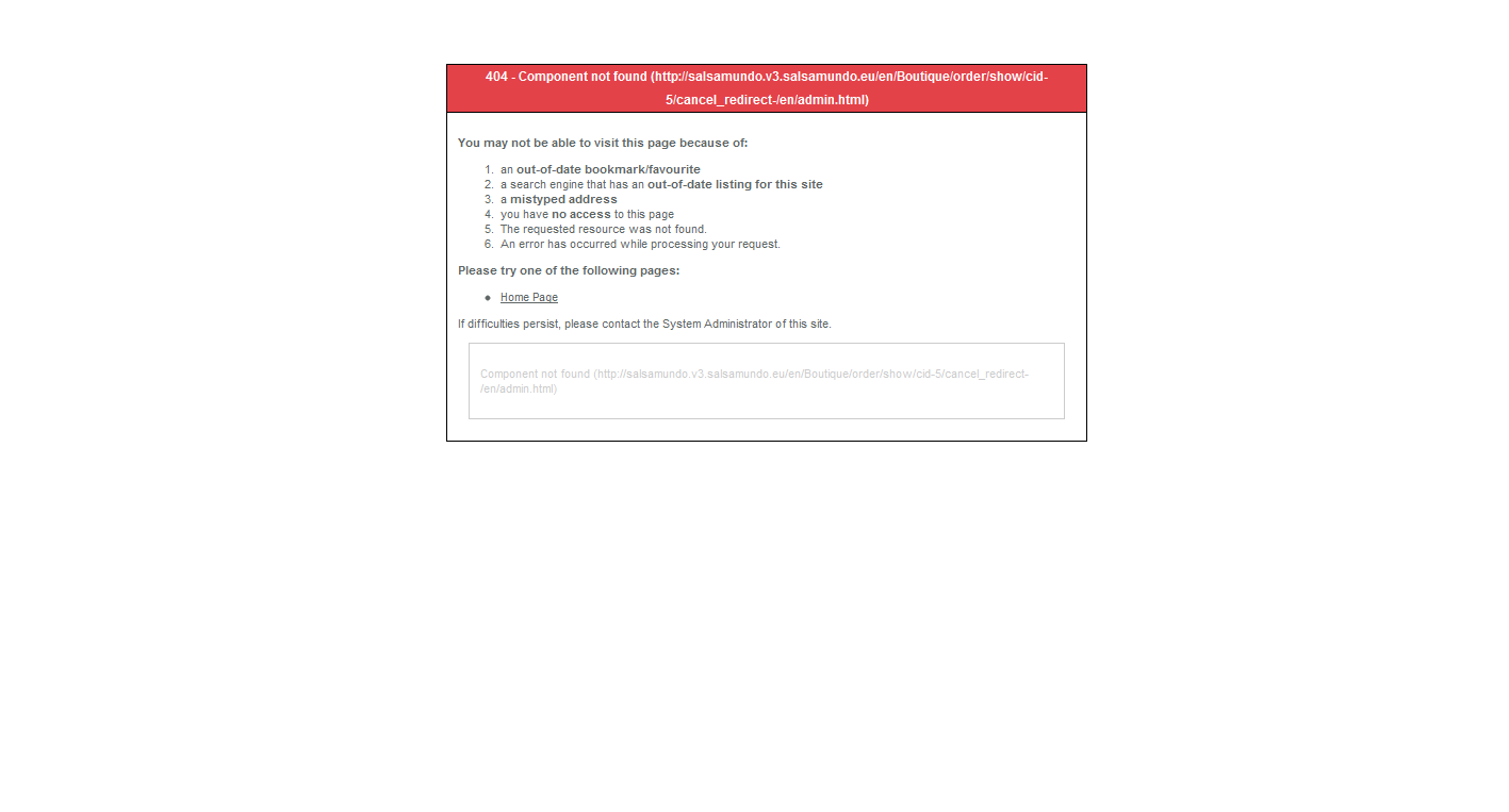

1- I installed the jomsocial plugin on my test website
salsamundo.v3.salsamundo.eu/
When i make an order i got the attached image error
"404 - Component not found ( salsamundo.v3.salsamundo.eu/en/Boutique/...irect-/en/admin.html )"
When i disable Sh404 url it's working. The problem is that i need this extenions :(
2- Is the any tuto to personalize the confirmation order email ?
Thanks !
Forian

1. That's indeed because of the SEF. Could you try to change the code:
$cancel_url = HIKASHOP_LIVE.'index.php?option=com_hikashop&ctrl=order&task=cancel_order&order_id='.$order->order_id;
to:
global $Itemid;
$url_itemid='';
if(!empty($Itemid)){
$url_itemid='&Itemid='.$Itemid;
$cancel_url = HIKASHOP_LIVE.'index.php?option=com_hikashop&ctrl=order&task=cancel_order&order_id='.$order->order_id.$url_itemid;
in the file plugins/hikashoppayment/paypal.php and try again with the SEF activated ?

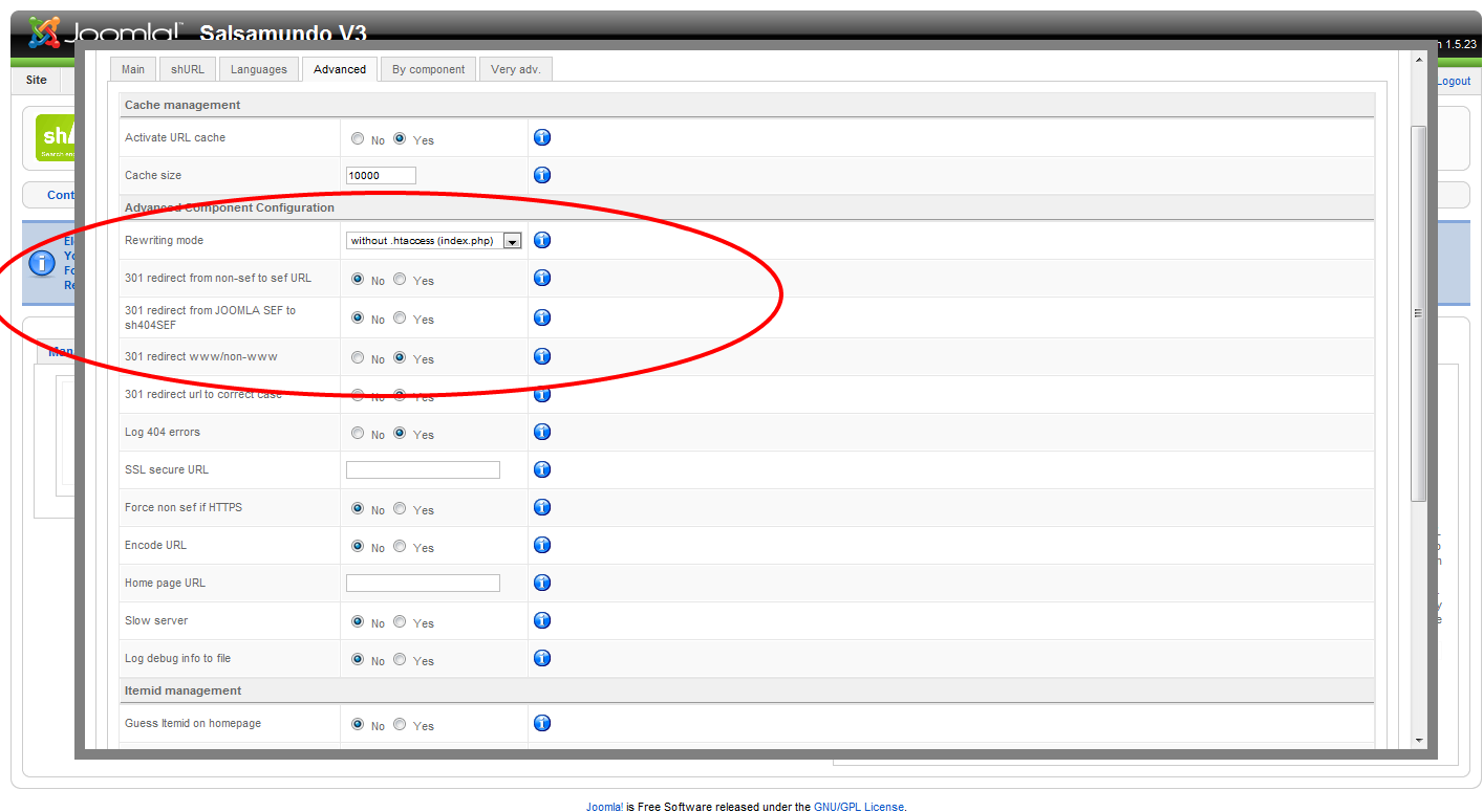

Please turn off the option "301 redirect from non-sef to sef URL" in SH404SEF.

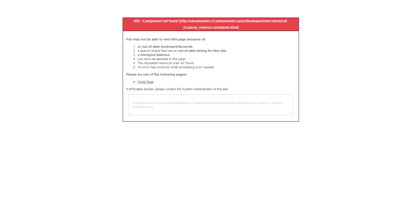

Well, I indeed tried the cancel link of paypal. But your screenshot red error was also for the cancel link.
If you want to fix the success link, you need to do a similar modification :
$return_url = HIKASHOP_LIVE.'index.php?option=com_hikashop&ctrl=checkout&task=after_end&order_id='.$order->order_id;
to:
global $Itemid;
$url_itemid='';
if(!empty($Itemid)){$url_itemid='&Itemid='.$Itemid;}
$return_url = HIKASHOP_LIVE.'index.php?option=com_hikashop&ctrl=checkout&task=after_end&order_id='.$order->order_id.$url_itemid;

13 years 9 months ago #20259
Hello there !
So I tried both solutions
1- I Changed the paypal.php. However It still not working. (error 404)
global $Itemid;
$url_itemid='';
if(!empty($Itemid))
global $Itemid;
$url_itemid='';
$debug = $method->payment_params->debug;
$vars = Array(
2- I disabled the tiny editor and default editor and it's working. However I need it, so what can I do ?
By the way what would it be easier for you to get access my back end ?
