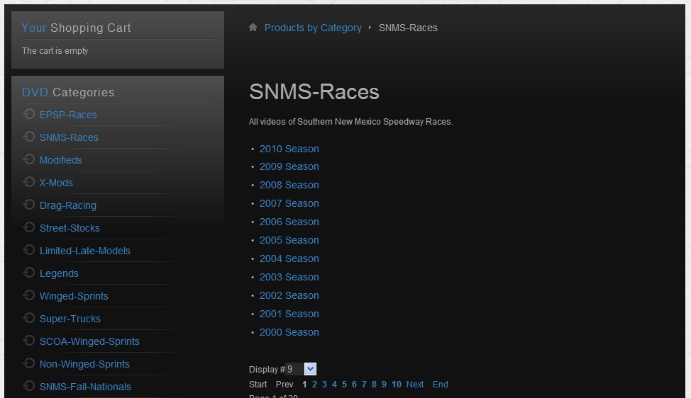

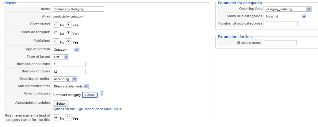

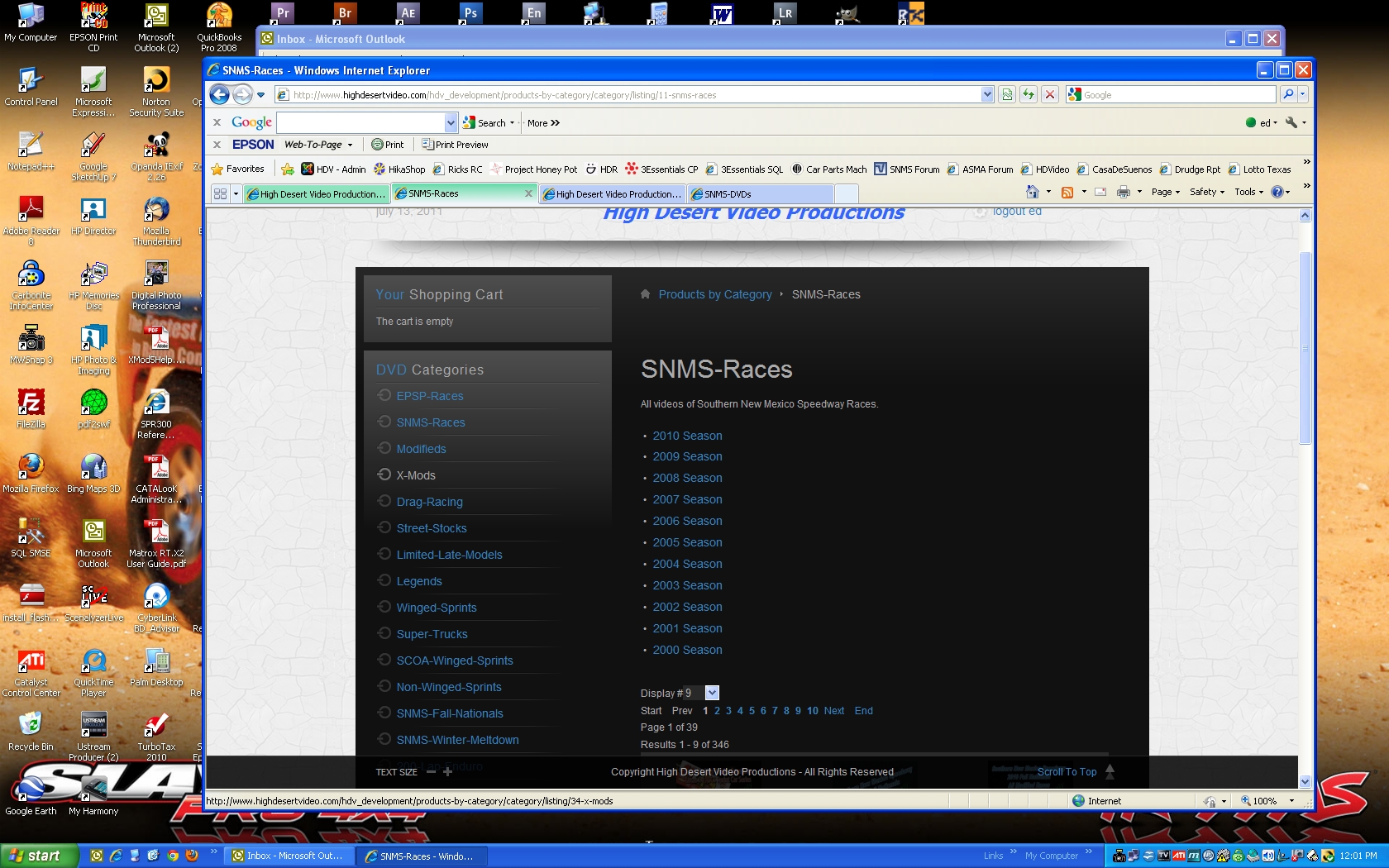

This morning I downloaded and installed 1.5.2 on my development site and noticed a problem with a Category List Menu display. It should display 3 columns and a maximum of 12 categories, and was doing that with the same settings in a previous version. Now it will only display one column in List mode but Div mode displays three. I'd rather use List mode so what do I need to do to get three columns back in List mode?

That's probably because you customized the CSS of HikaShop and thus you didn't get the modifications we made in it for the new way of displaying lists in columns.
You will have either to switch back to the default CSS and reapply your CSS modifications or put the new list CSS in your modified CSS file. I'm not sure but I think that we added the code below for that:
.hikashop_category_list_item, .hikashop_product_list_item{
float:left;
.hikashop_product_list, .hikashop_category_list{
display: inline-block;
list-style-type: none;
text-align: left;
