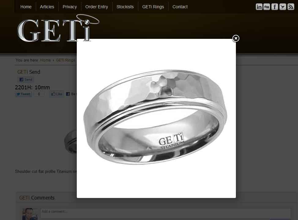

I've resisted looking at the documentation so far in true 'man' style but one thing I've noticed that, I don't know if it has any relationship to the original problem, is that on the product I've added in 'Plain Titanium Rings' category, when I open the exploded view of the product and then close it again, it closes Hikashop and returns to the homepage. I haven't noticed a setting that makes it do this - is this normal?

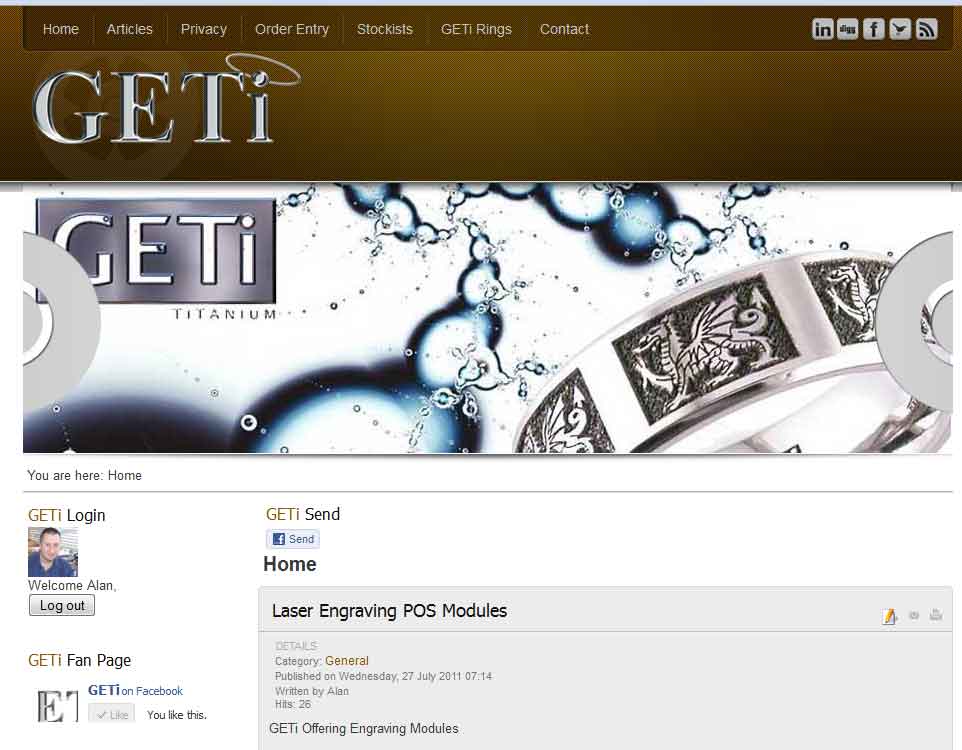

  • Posts: 15
13 years 8 months ago #22281
Certainly:
Click on product image to expand it:
  • Posts: 15
13 years 8 months ago #22282
then when you click on the cross to close the expanded image, the screen reverts back to the homepage:
  • Posts: 83602
  • Thank you received: 13533
13 years 8 months ago #22283
Mmm. That sounds like a problem with the modal library of joomla 1.7.
We tried to reproduce the problem on Joomla 1.7 on our end but it works properly so maybe you have a conflict with something else installed on your website. Or maybe it's related to your browser ? Did you try with other browsers ? Could you give a link to that page so that we can try ?
