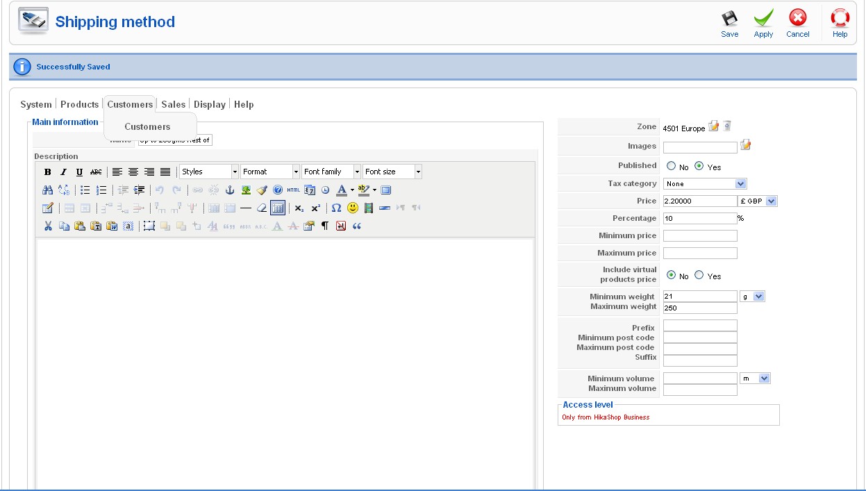

When I add a % to a manual shipping plugin, it doesn't give the correct figure, it just adds the percentage unit as a standard unit.
i.e £2.20 with +10% = £3.20 when it should = £2.42

Could you do a screenshot of the configuration page of your shipping method ?
You need to create a zone "rest of the world" via the menu System->Zones and add all the countries to it as sub zones.

13 years 7 months ago #25053
Attached screen shot.

13 years 7 months ago #25057
£2.20 with +10% is not equal to £2.42.
£2.20 means that the base price of your shipping method is £2.20.
Then, on top of that, there is a 10% supplement based on the order sub total amount. That means that if the total of the order is £10, there will be a supplement of £1 so the shipping price will be £3.20, which is probably why you had that shipping price on your checkout...

13 years 7 months ago #25061
Ah I see, so the calculation is +10% of the total order and not on of the delivery price.
