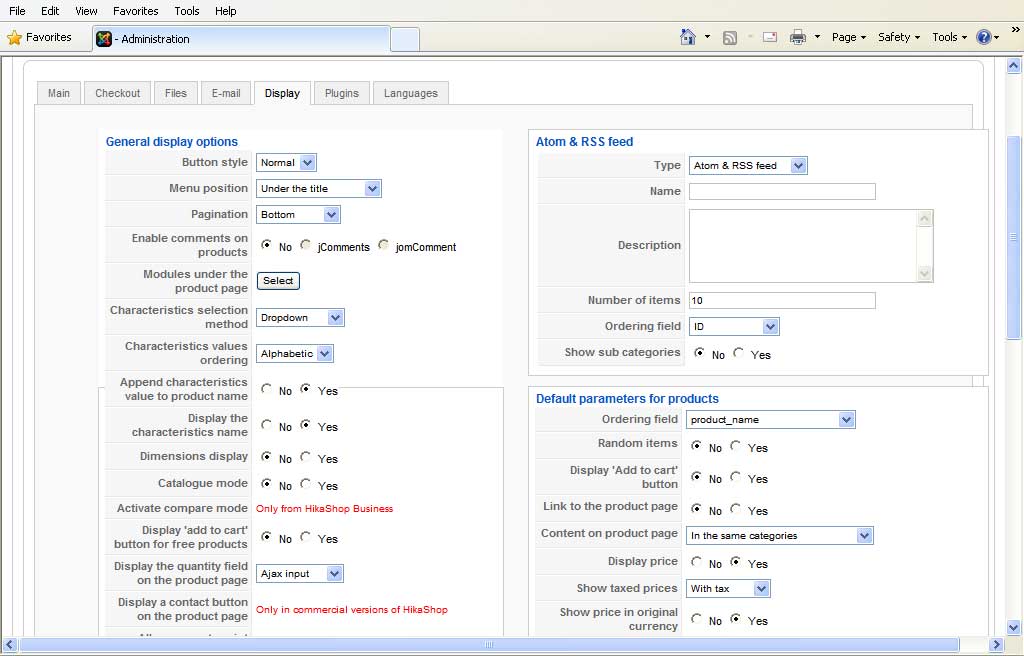

  • Posts: 67
12 years 11 months ago #33605
I am attaching screen shot to show you that I did do that but the products in the online shop do not show up in alphabetical order just the same.

For that, you need to edit the hikashop options of your products listing menu/module and change the ordering column from "ordering" to "product_name". In your case, it's the module with the id 26 that you can edit via the menu Display->Content modules.
  • Posts: 67
12 years 10 months ago #33696
are you referring to the section called Default Parameters for Products? Coz if yes I already have the product_name chosen as can be seen on the attachment I uploaded a few posts back

12 years 10 months ago #33719
No, that's the Display tab of the configuration. I'm talking about the Display->Content modules menu that you can see under the title of the screen.
