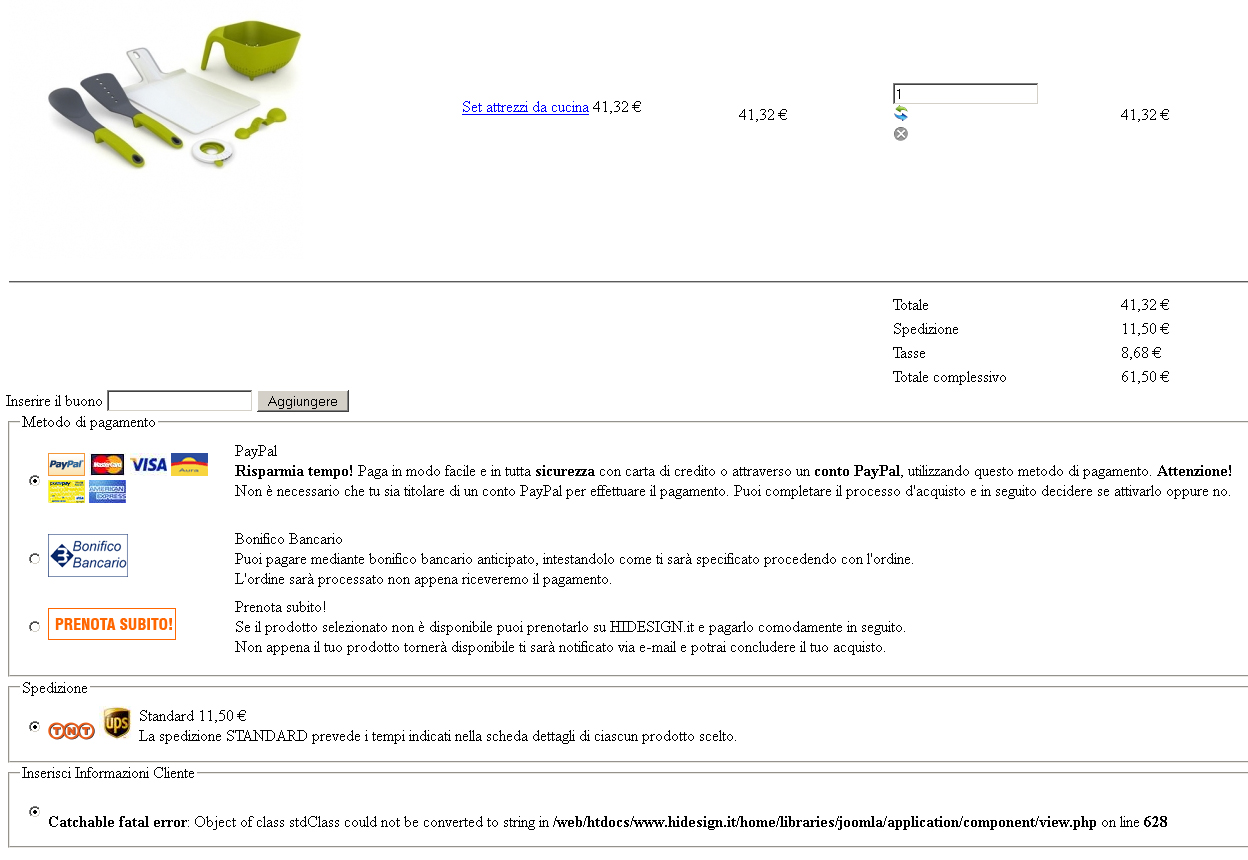

I Nicolas,
in the cart when I try to set a new address, the page crashes. it appear like without CSS and in the bottom of the page
there is this:
Catchable fatal error: Object of class stdClass could not be converted to string in /web/htdocs/www.hidesign.it/home/libraries/joomla/application/component/view.php on line 628
HELP!!!

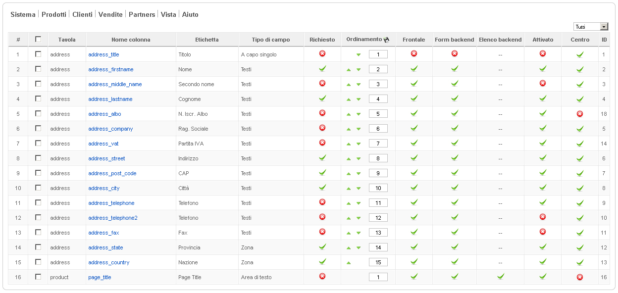

  • Posts: 251
13 years 6 months ago #26449
The problem exist for all the user with a complete address informations...

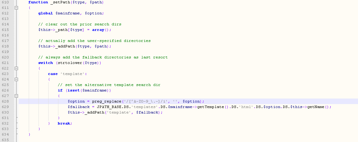

You could also edit that file just before that line and add:
var_dump(debug_backtrace());
That would tell us from where that file is called.
  • Posts: 251
13 years 6 months ago #26472
I activated the Debug mode in Joomla but nothing...
this is the portion of the code in that file:
I see that if the customer do not have any informations like address or telefone number etc. all works fine, but if I add this information that is the result.
Last edit: 13 years 6 months ago by Nello.
  • Posts: 83604
  • Thank you received: 13535
13 years 6 months ago #26475
if you change that line by
$option = JRequest::getVar('option');
it should work. However, that does solve the real problem. It's a workaround.

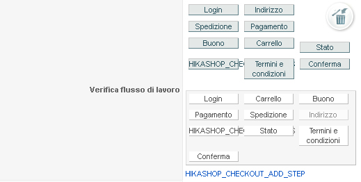

for me the problem is in the cart workflow.
Indeed moving the "address" tab it produces that error.
This is my setting and it doesn't work.
I need to set two step to get it works.
  • Posts: 251
13 years 6 months ago #26478
Is the same on your demo. If you put the Cart Tab before the Address Tab you'll get an error on the cart.
