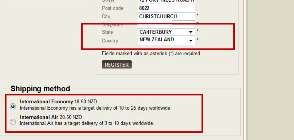

If I make a shipping inside New Zealand method and an international shipping method, I'm expecting there will be no shipping displayed until they enter their address on the first checkout page. Instead internationl shipping is displayed (see screenshot). How do I hide shipping options here?
Then, on the next page I'm expecting just New Zealand options to be shown. Instead, although the New Zealand options appear, the international options remain. How do I make these international options disappear for NZ people and remain for others?

In the configuration, you can configure the "main tax zone" option. That's the zone which will be used before the user enter his address. So it's normal that you still see shipping methods before your register if the zone in that option is in the zones of your shipping methods.
How dod you configure your international shipping method ? If you still see it when the address is new zealand, it's because either you didn't set a zone restriction, or the zone you set in there contains new zealand as a sub zone of it.

I think it's because I don't have any zone restrictions set at all for my international shipping options. With my main tax zone set for New Zealand and default country field as New Zealand, then the shipping set for New Zealand shows because it has New Zealand as the zone, and the international shipping shows because it doesn't have any zones set for it.
So I'm hoping setting the international options as everything but New Zealand should make them disappear, unless the customer gives an international address. But how do I set the international shipping zone as everything but New Zealand?? The select all option only works for one page and there are 44 pages !! :ohmy:

You need to go in System->Zones and create a new shipping zone that you will call "international". When you do, you will have a sub zone area where you will have to enter all the countries except new zealand. Then, you will be able to use that shipping zone in you international shipping method so that it displays only for addresses outside new zealand.

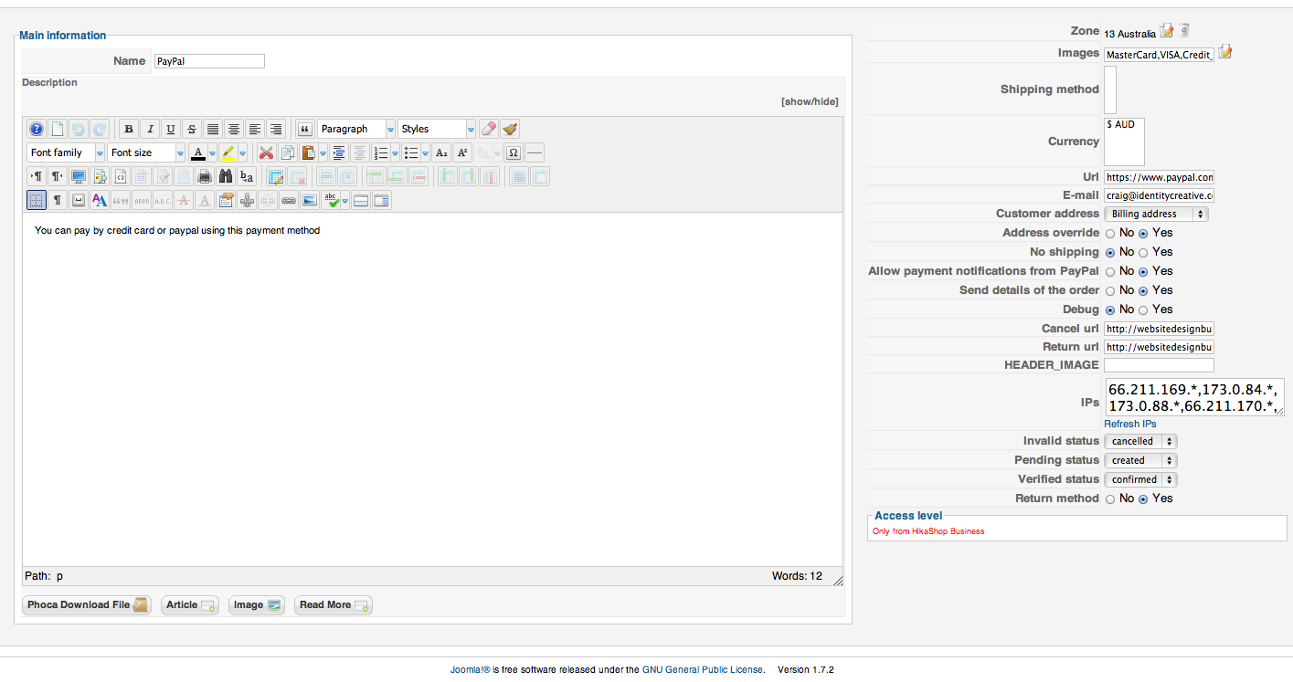

Could you do a screenshot of the options of the paypal plugin ?
Could you try to save the joomla options of the paypal plugin in the joomla plugins manager and see if that helps ?
  • Posts: 19
13 years 5 months ago #28657
Hi.. I've attached a screen shot of the Paypal plugin.
I also have Hikahop on another site, and I've mirrored settings as the other one works.
The only difference is, is that this new site has the newer version.
But it keeps saying ' no payment methods found' when I've got the Plugin enabled.
Cheers
  • Posts: 83603
  • Thank you received: 13533
13 years 5 months ago #28663
I see that you limited the plugin to australia.
Is your main tax zone set to australia in the configuration ? If no, you should do that.
Also, is the address of your user in australia ?
Otherwise, that would also explain why it's not displaying.
Lastly, could you try to save the joomla options of the paypal plugin in the joomla plugins manager and see if that helps ?

Hi Yes.. it is limited to Australia... as the site is not international. Aus based.
Same as the Tax Zone is set to Australia as well.
And the address is set to Aus... these are the settings I require for the site.
How come it's not displaying. As I only need these settings. Not other countries.
I checked the Joomla pluggins manager and all is fine.
Please help me get it to work in Aus. Cheers, Craig

You hadn't save the paypal plugin joomla options in the joomla plugin manager. I've done it for you and it's OK now.
