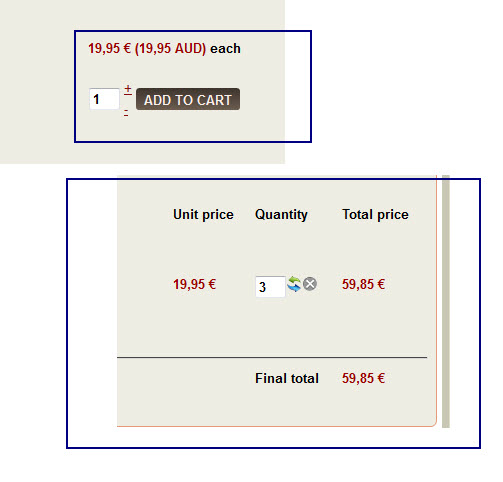

Hi there,
Just installed hikashop business 1.5.4 on joomla 1.7.2.
I've changed the currency from the default euro to aus$, but the change isn't showing on the frontend. I still get the value shown in euros (see screenshot).
I've disabled euro and unpublished in the list of currencies. I've tried flushing the cache in joomla and the browser, but no luck.
Any ideas on this, maybe I have missed something, hopefully it's easy?! :)

Did you change the "default currency" option of the main tab of the configuration ?
Also, once you do it, make sure that you logout/login from the front end in order to reset the session data.
  • Posts: 21
13 years 5 months ago #27960
Um, um, no! Didn't, do, did, fixed! Many thanks for that.
