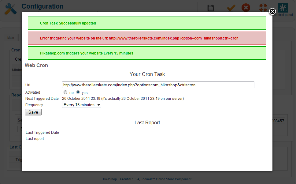

  • Posts: 164
13 years 5 months ago #28334
So, I setup a Cron thingy, and created it, and saved it. But I got this error.
  • Posts: 83603
  • Thank you received: 13533
13 years 5 months ago #28336
Going on www.therollerskate.com/index.php?option=com_hikashop&ctrl=cron
I can see that your cron was triggered.
So it seems to be working.
You can check that in more details by following the documentation there:
www.hikashop.com/en/support/documentatio...cron-task.html#check

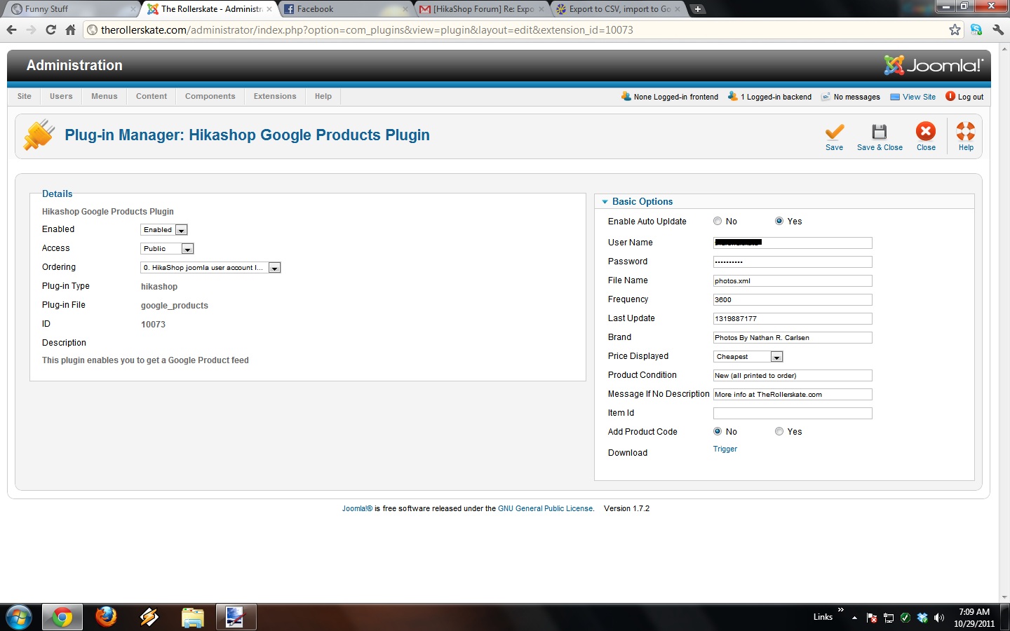

  • Posts: 164
13 years 5 months ago #28528
I think I got everything setup correctly now, but I still don't see any products in Google Merchant. I feel like I may have missed something.
  • Posts: 164
13 years 5 months ago #28569
No, I am not receiving the cron emails, even though it is saying that it is working by giving a last run time. Attached is the plugin screen shot.
  • Posts: 83603
13 years 5 months ago #28582
What if you update your google products on your merchant account using the xml that you can download via the trigger link on that screen ? Does it displays any errors ?
Do you have any errors or messages regarding that photos.xml file on your google merchant account ?
  • Posts: 164
13 years 5 months ago #28589
So, i DID have an error when I did the cron thing, which I did provide a screen shot. But, when I tried uploading it manually, it didn't give me any errors.

  • Posts: 83603
13 years 5 months ago #28608
The mpn attribute is only added when the "add product code" option is turned on in the plugin so you should do that.
the brand attribute is only added when you have something in the "brand" input field of the plugin's options. I see that you had it filled in your screenshot. Did you empty it since then ?
The "google product category" option is not implemented at all in the plugin. That's because like for the other two parameters they are optional. It's strange that you get these errors.
For that last warning, the only way to remove it will be to add a line like this:
$xml.="\t".'<g:google_product_category>CATEGORY</g:google_product_category>'."\n";
where CATEGORY is the name of your category based on the explanations there (you need to choose between the list of possible categories on that page):
www.google.com/support/merchants/bin/ans...?answer=160081&hl=en
You can place that line of code just before the line:
$xml.="\t".'<g:shipping_weight>'.$product->product_weight.' '.$product->product_weight_unit.'</g:shipping_weight>'."\n";
in the file plugins/hikashop/google_product.php
Then, try to download again the xml and import it in google again. These error messages should not display anymore.
