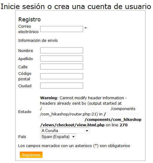

In the checkout page, an error appear:
Warning: Cannot modify header information - headers already sent by (output started at /.../components/com_hikashop/router.php:21) in /.../components/com_hikashop/views/checkout/view.html.php on line 270
It has relation with state but I don't what happens because the state seems to be ok.
Thanks for your help.
  • Posts: 83604
  • Thank you received: 13536
13 years 5 months ago #30434
in the file /components/com_hikashop/views/checkout/view.html.php you can change the line:
header('Content-Type:text/html; charset=utf-8');
by:
if(!headers_sent()) header('Content-Type:text/html; charset=utf-8');
and that will remove the warning message.
