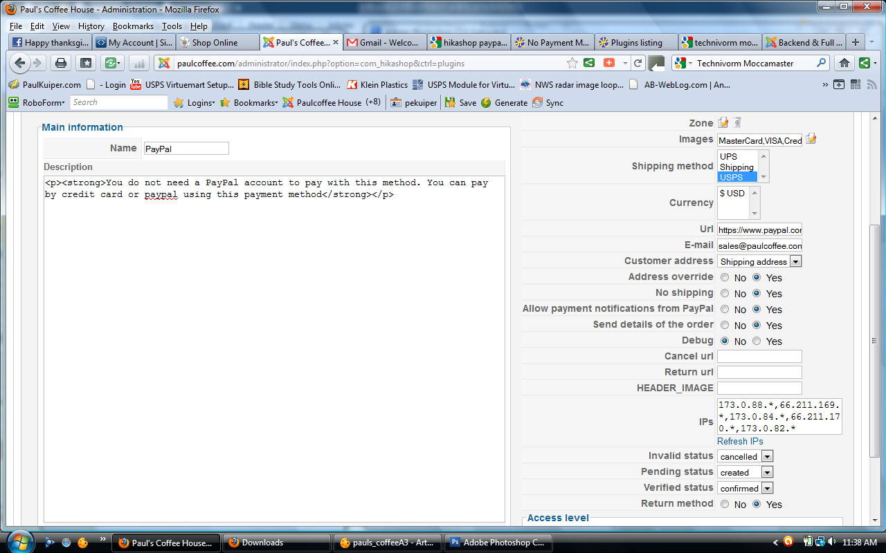

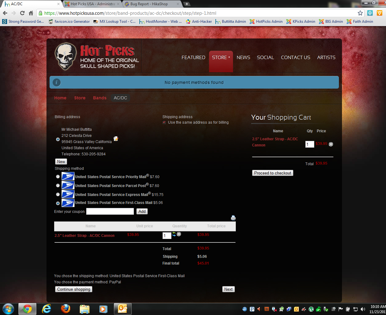

I have both PayPal and PayPal Pro enabled in my cart, and I am getting this error "No Payment Method Found" when a user goes to checkout and they CLEARLY have PayPal indicated for payment.
This is becomito leave. PLEASE! I need help getting these issues fixed!

That's because in your payment methods options, you restricted them to only one shipping method.
I've unselected that restriction as you already gave us a back end access and the problem is solved.

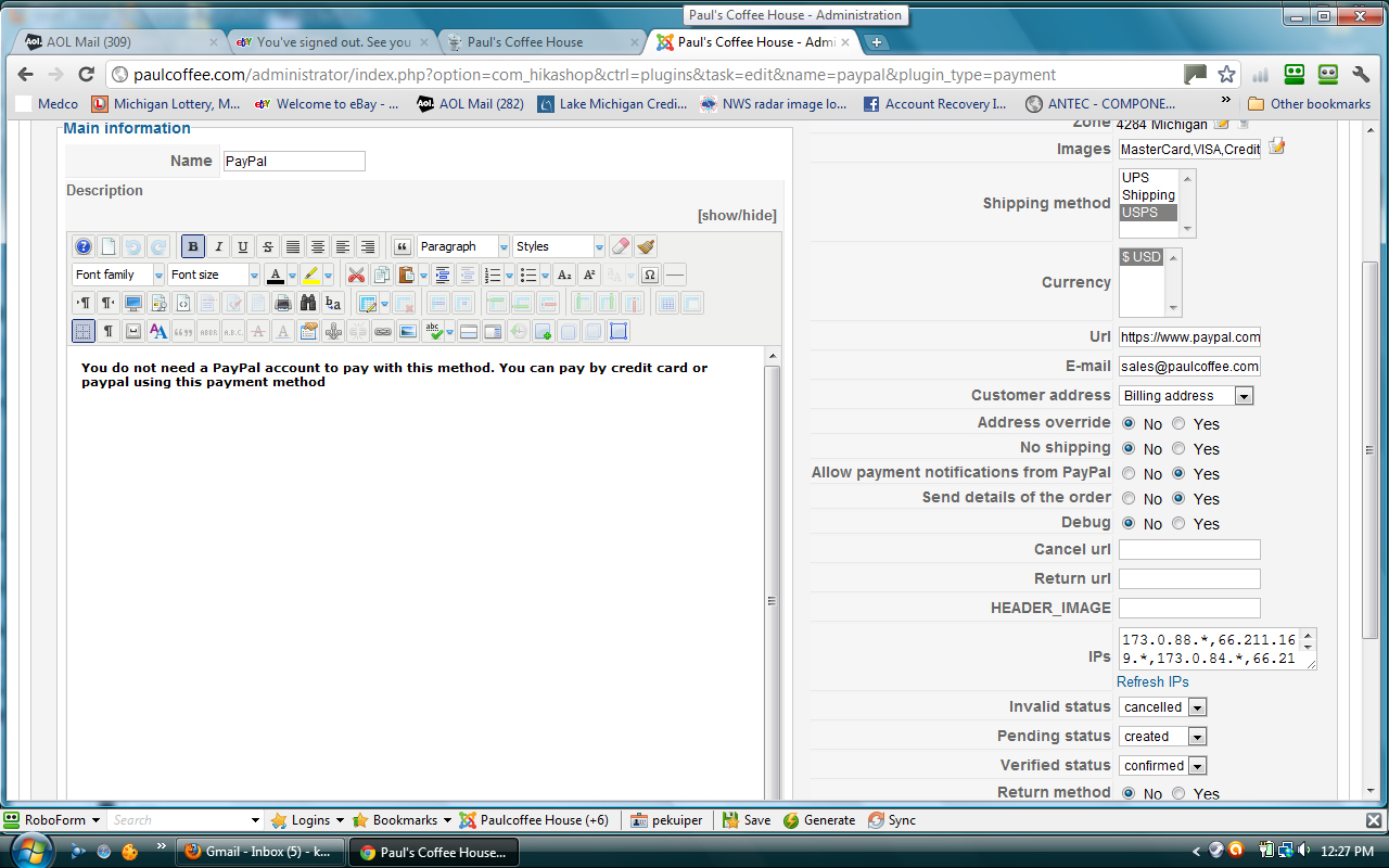

  • Posts: 10
13 years 5 hours ago #30866
Must not have taken my photo the first time, sorry
  • Posts: 82863
  • Thank you received: 13372
13 years 5 hours ago #30867
You should deselect the shipping method restriction you set there and try again.
  • Posts: 10
13 years 4 hours ago #30869
No luck.
  • Posts: 82863
13 years 4 hours ago #30870
Now I see that you selected both a shipping method AND a currency restriction.
To deselect a selection in a multi select, you should maintained pressed the ctrl key on your keyboard and then click on the selected items. Then, save the payment method and it should work.
  • Posts: 10
13 years 4 hours ago #30871
WOW, brain fart - yes it worked. Don't know why I clicked it in the first place. Thanks for your awesome help.

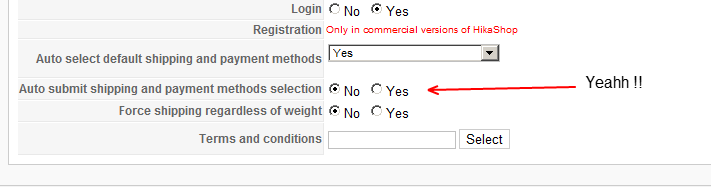

  • Posts: 84
12 years 11 months ago #33303
No payment methods found
a solution
HikaShop -> configuration
disable auo submit.....
by
Javier

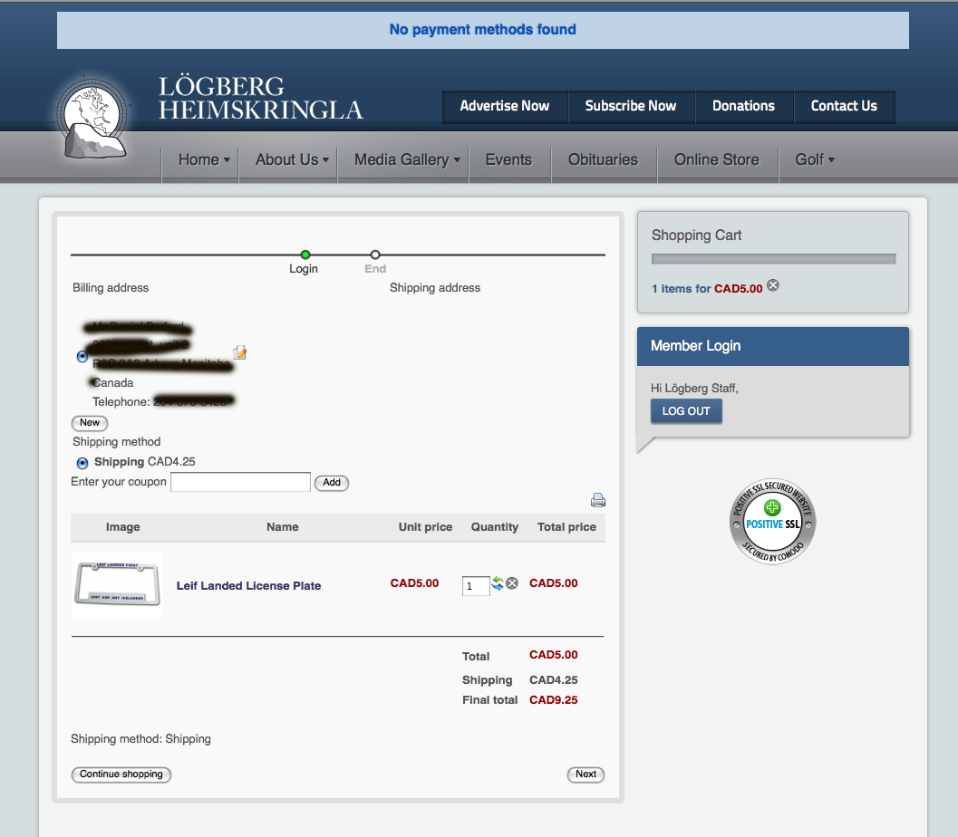

  • Posts: 18
12 years 2 weeks ago #74834
I have read threw the forms and tried everything that could stop the "Authorize.net payment plugin" from working.
I had upgraded the HikaShop so that I allow users not to have to register and just buy products...
Anyways now my Authorize.net payment plugin wont work.
Please see screen shot. And may I just give you access to the site Nicolas?

  • Posts: 18
12 years 2 weeks ago #74847
turns out "Authorize.net payment plugin" is for USA currency only and if your main currency is set to anything other the us dollar it will not work.
So two places to make sure you have USD.
Configuration / System / Main "Main currency" $USD
Configuration / System / payment methods / HikaShop Authorize.net payment plugin / "price" USD
Now this is an issue for Canadian shopping carts.
If you have a work around please let me know.
  • Posts: 82863
12 years 2 weeks ago #74861
The Authorize.net payment gateway is only for USA based merchants. There is no work around for that. You'll have to use another payment gateway if you're in Canada.
