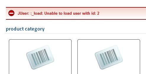

When I go to the shop, when I AM logged in, I get the following error:
JUser: :_load: Unable to load user with id: XX
More details:
- The XX changes depending on the page.
- the XX does not represent an actual user number (as far as Joomla is concerned)

Could you do a screenshot of that error ? Do you have more information with that message like the file where that happens and the line number ?
That would help us understand why you have that problem.
Also, could you give a list of all the user plugins you have installed on your website?
Did you unpbulish/remove the HikaShop user synchronization plugin ? If so you should put it back.
Did you copy the tables of HikaShop from a previous website ? That might lead to a desynchronization of the users between HikaShop and joomla.
If it's a new website not yet in production, you could try that:
empty the hikashop_user table and install again the HikaShop package. That shoul resynchronize all the users between Joomla and HikaShop and might solve the problem if it comes from that.
Screenshot attached. No other message no file reference and I can still access the shop. Problem is that I do not have the shop fully setup as far as checkout as I plan on using the site in catalog mode.
