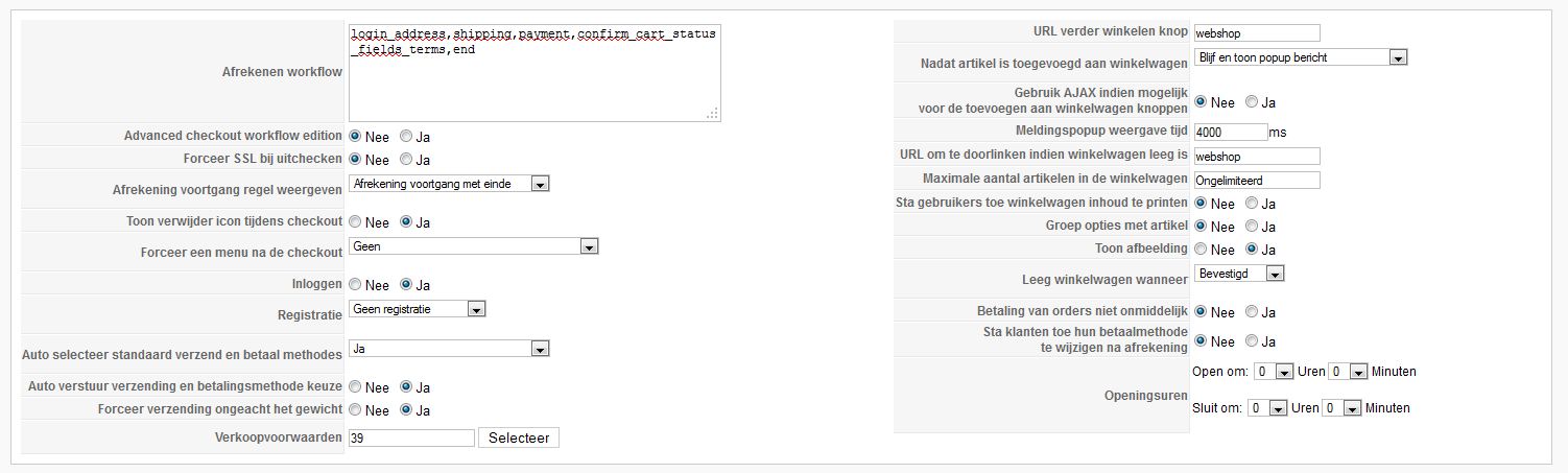

I am currently struggling with the checkout options, not sure whether I'm doing something wrong or whether it's a bug.... I am working on a local copy of my site, as I do not want to play around before it's finished.
I use the following workflow: login,address,shipping,payment,confirm_cart_status_fields_terms,end
Version is Essential 1.5.5.
Registration is switched off, as I want guest checkout. That is why I also set Registration to No.
When I first sign in using a normal Joomla log-in annd then enter the shop, I can order and checkout without problem, but when I'm not signed in the shop doesn't work. When I add a product to my cart, the "Add to cart" button brings me to the home-page of my site and nothing happens, cart still empty. I played around with the setings for Signon, Registration and workflow, but no changes.
See attached a screenshot of my checkout configuration:

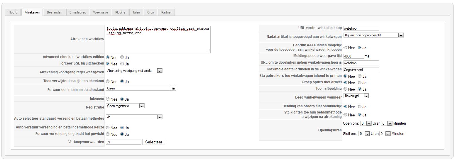

  • Posts: 130
12 years 11 months ago #33200
And a screendump:

It's hard to say without a link to the website but what you're describing doesn't come from all these settings.
If a product cannot be added to the cart it comes from one of these points:
Custom item fields not added properly in the database (you can check that by turning on the debug mode in the joomla configuration)
Update problems of the database after an update of HikaShop (you can check that by turning on the debug mode in the joomla configuration)
You have some caching activated (you should check that the joomla cache option in the configuration and the joomla system cache plugin are both disabled)
So you should first check on that.

  • Posts: 130
12 years 11 months ago #33327
Thanks, switching off caching solved the issue. My checkout works ass desired no, so I will proceed to fill my shop.
