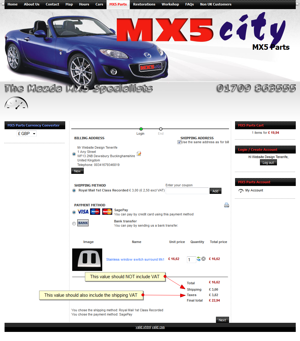

This may be remedied easily but may also be a bug so thought it deserved to go here.
I've been configuring the free version of Hika to demonstrate to a client and after reviewing the features list last night I will be recommending that he buy one of the paid versions. However, that aside, this issue will stop him using Hika all together.
We had big problems with Red's method of calculating shipping and VAT. In the UK you should show ALL VAT seperate, including that for the shipping and Hika appears to be adding the VAT onto the shipping. VAT is indeed a Value Added Service so is subject to VAT at normal rates.
I've attached a screen grab for your review...

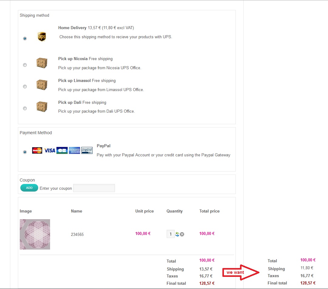

hello
i have the same problem as you can see from the attached image.
please advice.
thank you
