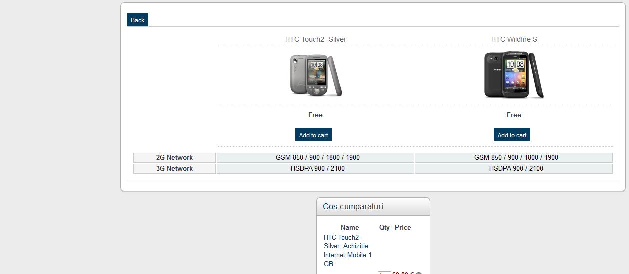

Tested with 2 different joomla templates and having same problem: when i compare 2 or more products, all modules from left side are displayed below the comparison area (see attached image)

We don't have that problem on our end. I just tried and it worked ok. Could you give the link to that page so that we can see its HTML ?

There is a closing div tag missing on that page.
Please edit the file "compare" of the view "product" via the menu Display->Views and add the line:
</div>
at the end of the file and that should solve the problem.
